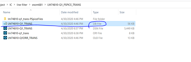

hello Praveen GD,
That link is PSICE model, not spice model. It will show some errors, if using PSICE model in the LTSPICE software . it will show some errors when simulation.

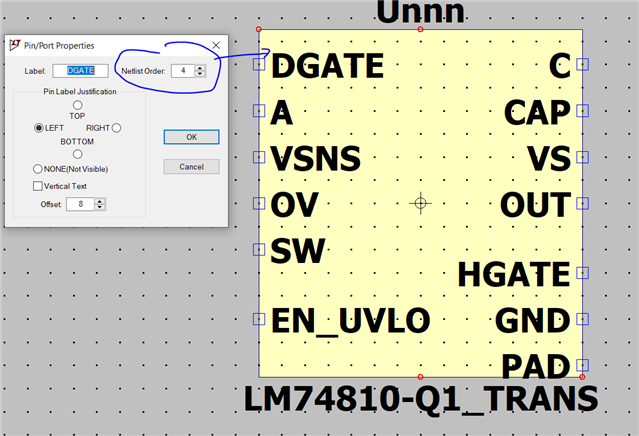

Besides, model pin number is different with datasheet(eg:DGATE , number 1 in datasheet; but in psice model , it show number 4.)

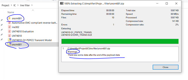

may be a problem with the LM74810-Q1 compressed file(https://www.ti.com/product/LM7481-Q1#design-tools-simulation.) ,see below ,when extracting document, show waring.

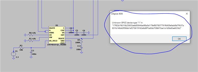

hello Praveen GD, another possible reason is that's an encrypted model ,see below. so based on those information, could you help me ? thanks
Hi Dongliu,
We can share unencrypted model under NDA. Please reach out to our field team supporting you to receive unencrypted model.
