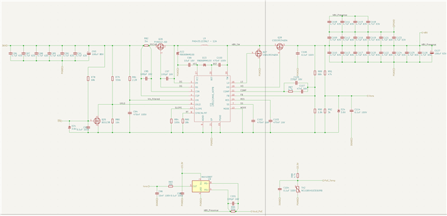

I have an issue where the low side FET and the disconnect FET are occasionally failing short circuit on startup of the regulator.
My circuit consists of the standard application schematic LM5121 configured for ~48V output voltage stepping up from a voltage range of 25V-42V.
The regulator is enabled/disabled through the use of a logic level FET that pulls the UVLO pin to ground.
The disconnect FET used is the PXN012-60QL, and the switching FETs are ISC230N10NM6ATMA1.
The purpose of this regulator is to power a stepper motor driver and power a PoE switch, with what I estimate is an additional ~300uF of extra load capacitance on top of what is shown in the schematic attached.
The stepper driver does not immediately start on power up, so the load on the output should be mostly passive.

Adding the local relevant layout where the regulator is. The net VMOTOR is the output rail.

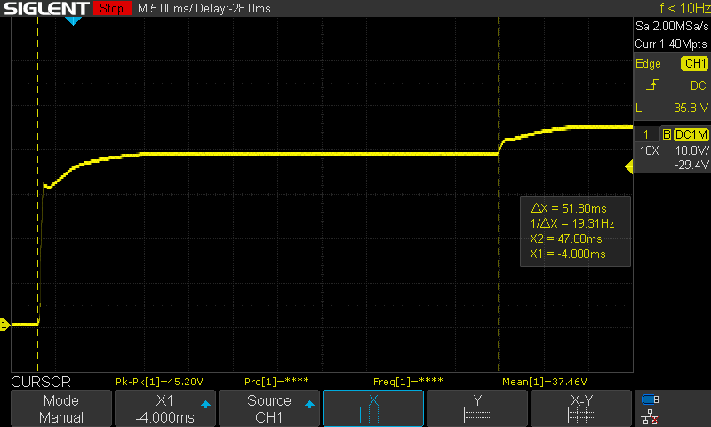

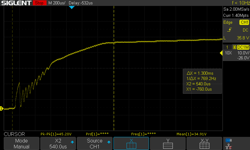

    Also in the midst of debugging I tried to bypass the disconnect FET and added a 100pF capacitor between DG and DS. And upon turn on of the input supply the LM5121 started getting hot and wouldn't switch after enabling.
    Attached is the gate voltage of a working regulator's disconnect FET vs DS and the output voltage with an input of 32V upon enable. Yellow trace is DG.

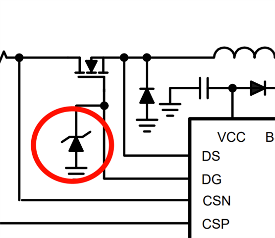

    I do have one further question. Is it possible to modify this design to remove the disconnect FET. I have attempted to short over the FET and populate the 100pF capacitor. But this results in immediate destruction of the LM5121.
    I have another set of modified boards with added transient protection according to the datasheet on the DG pin. Replaced the disconnect FET with a higher rated one with better SOA and replaced the flyback diode before the inductor with a higher rated schottky. I'll let you know if that version is more reliable.

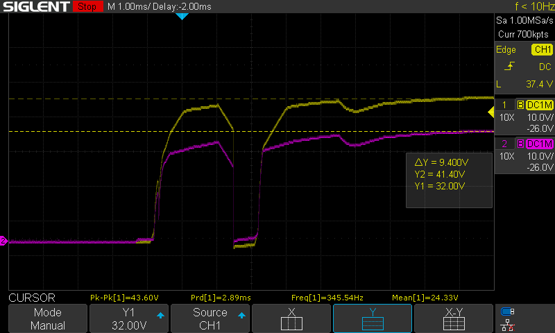

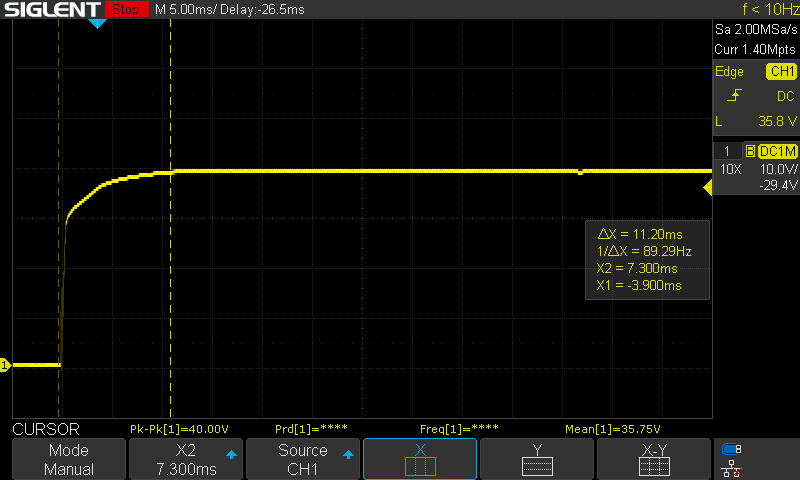

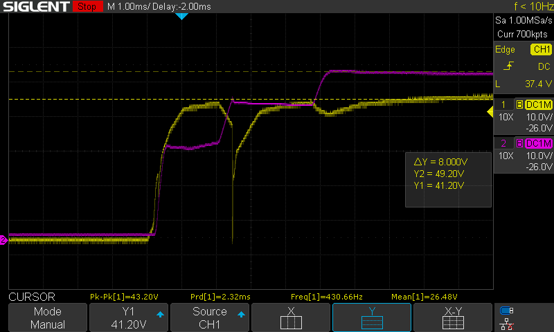

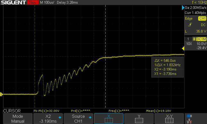

    Attached are some additional waveforms during testing of the regulator on the times it worked with the input current sense resistor replaced with a 7mOhm at 40V input voltage. I also replaced the DS210W with RB068MM100s as a further test.
    So far this one hasn't failed after >10 enables with no load, I'll edit my reply if it fails.
    DG pin start up:
    DS pin full start up:
    DS pin zoomed in on inrush limiting:
    Output voltage on startup:

    1: Bypass of disconnect FET:
    A possible reason why disconnect FET failed with a cap from DG to DS could come from the driver, who cannot support the artificially increase gs capacitance. Meaning the FET gets too slow.
    In theory it should be possible to bypass the FET, but you have to pay special attention to the DS pin, as having the Vin signal at this pin directly could lead to errors. Therefore an additional resistor at the DS pin might be required.

    Also is there a way to protect the disconnect pin on the LM5121 if I continued to use the disconnect FET? Is the schottky diode described in the application schematics in the datasheet sufficient to do this?

    I am not sure if there is a elegant way to protect the disconnect FET.

    If it fails again, I'll just cut the DS trace and solder a 500k to ground as shown in the datasheet to allow bypassing of the disconnect FET as I have an upstream hotswap controller to do that in this board.
