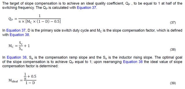

My customer is using UC2842 for their design now, and they confused about the calculation equations of slope compensation in our datasheet. They want to know how are the equation37, equation38 and equation39 derived. And how the slope compensation works.
