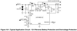

In trying to use LM74720-Q1 as an ideal diode OR controller with inrush protection, there is still 2uF of capacitance that will see an instantaneous dV/dt (purple boxes below, from the EVM design) if a battery or power supply is plugged in live. In bench testing, this causes >40A inrush current spikes. Is the only mitigation for this to implement a series hotswap controller, or can we reduce the cap values circled? If a hotswap controller is the only solution, is there a TI part that is recommended to use in series?

    Yes, C1 and C8 can cause some inrush current during input power supply hotplug. The C9 capacitor will not cause inrush current during hotplug because this is the output capacitor of the internal boost converter.
    Are you okay to use LM7480-Q1 instead of LM74720-Q1 ? LM7480-Q1 just needs 2x 0.1uF capacitors (CVS and CIN in the image below) unlike 1uF required for LM74720-Q1.
