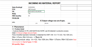

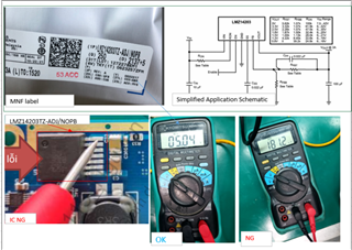

We are using LMZ14203TZ-ADJ/NOPB part of TI but we are having the proplem as this above:
Customer feedback IC PN: LMZ14203TZ-ADJ/NOPB  was NG detected in production process.
Detail: IC Out put voltage was out of spec.
Follow Simplified Application Schematic in Datasheet from MNF: With  Vin = 7.5- 42V,  Ron 100K ohm, Rfbb= 1.07kohm, Rfbt= 5.62 kohm => Vout = 5V
But actual products  setup:  Vin =12V,  Ron 100K ohm, Rfbb= 1.07kohm, Rfbt= 5.62 kohm Vout = 0.1- 0.2 V => Out of spec => NG
NG quantity: 50pcs
Error and operation details are in the attached file.
Please help us check this error.

  • Dear Youhao,
    Thank you for replying, currently error rate 95/600pcs. 95pcs error and 505pcs is ok.

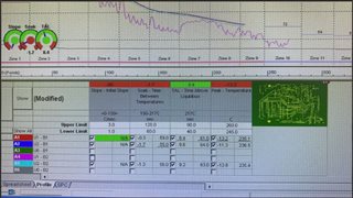

  • Dear YouHao,
    This is temperature cycle. pls help me check it. if you have any comments , please help me feedback soon. Thank you

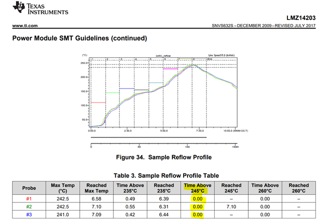

  • Dear Daniel,
     I think all your three latest posts are duplicates, right?   I am afraid your profile exceeded what is recommended in the datasheet, which I copy and paste below for your convenience.
    Hope this clarifies.
    Youhao
  • Dear YouHao,
    Can you help us circle the points that exceed ( circle your photo and my photo) and send again for us ? we will compare and find reason.
    Thank you.
  • Dear Daniel,
    If you see our datasheet chart, the temperature is always below 250C.  In your chart, your limits is set at 260C, and your recorded peak is 255.8C. I wish I could attach a snapshot to circle the areas, but somehow the e2e does  not allow me to attach.  Wish my description is clear enough?

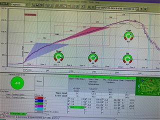

  • Hello Youhao,
    After I were received your recommend, We set up the soldering furnace temperature as the setup for the white circuit board, without components and solder, after having the components and solder, the temperature at the component when going through the actual soldering furnace will be lower.We installed the sensor on the component body on the circuit board and ran it through the soldering furnace, the highest temperature on the component body when going through the soldering furnace was about 236 degrees, details according to the attached photo.
    We have installed a temperature sensor to test and found that the temperature is as shown in the picture.
    If you have any solutions, pls help us share it.
    Thank you.
  • Hi Daniel,
    Honestly I am an electrical engineer and this needs to consult with an expert of manufacturing flows with PCBs.  I might be wrong, but you have achieved 135C and never exceed 245C, and this should be good enough?  If you want to get a little higher temperature, you may set your Oven max slight higher, or slow down the board travel speed inside the oven, and this can fine tune the temperature to what you want to achieve, right?
