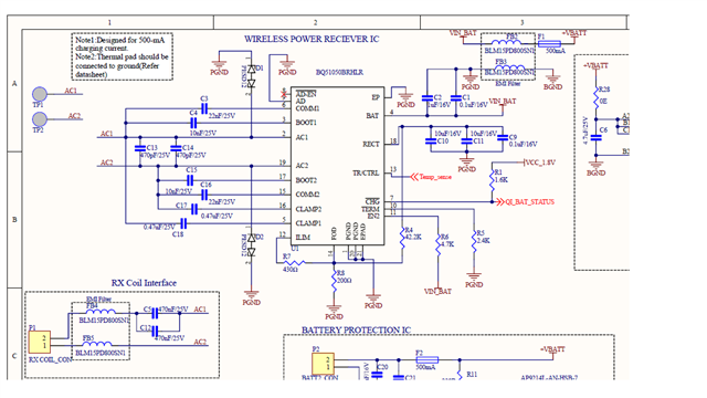

We have used BQ51050B as receiver with Rx coil (WR222230-26M8-G) and BQ50002AEVM-607 as transmitter in our project. We are unable to charge battery and don't know how to solve it. I have attached our schematic file. please review it and suggest the possible solution. It will be appreciated.
