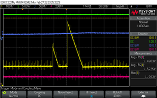

Here are some measurement:
CH1: ACSP4
CH2: VIN_CSNIN (input 12V)
CH3: output voltage
CH4: VREF
The VOUT_COMMAND (21h) was set to 1.1 V.
This fault trigger with a light load (~ 1A), but also without any load.
If we follow the formula for the Iout ((ACSP4– VREF)/0.005), the second peak reach 98.6 A, which justifies the OCF.
We were wondering why this is happening and how to prevent it.
This is not happening every time, it is hard to reproduce, but we have seen it 1 every 100 startup (approximately).

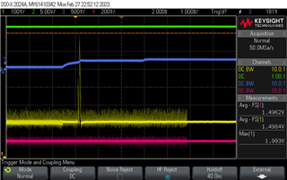

When the startup succeeds:
Here the peak is at 53.6A, and no OCF occurs, although there is no charge.
