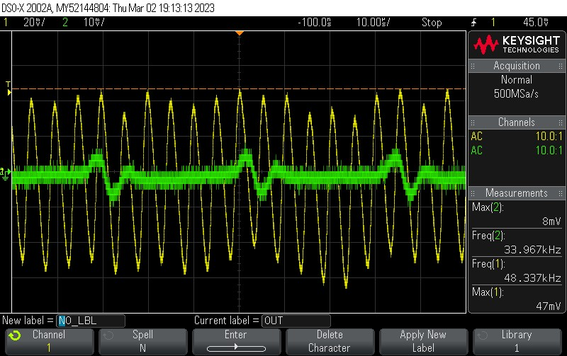

    I've already tried to test my LDO PSRR yesterday
    but i found out that my waveform didn't same like the one in the document TI show in the (left below), and mine (right below) :
    The yellow part is the Voltage ripple input and the green wave is the voltage ripple output.
    when i did the calculation the result only 15.36dB which the result is really far from the recommendation is 45dB
    can you give me a solution and explain to me what happend ?
    Thank you

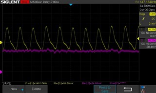

  • This is the result of removing Cin (Picture Below)
    as you can see we got the ripple input but not the ripple output.
    and btw we don't have network analyzer in our company
    Thank you
  • Hi Ihzany,
    Quick follow-up questions.
    On the first scope shot you shared, your input frequency was 48.3kHz, and for the second scope shot I see a 148kHz, what is the actual intended frequency?
    Overall, we can somehow relate Power Supply Rejection Ratio as a filter, therefore, if there is some ripple on the input, we would expect a smaller (or cleaner) signal on the output, which is what you are seeing a smaller amplitude on the output side.
    Here are some recommendations for using the scope method:
    1) Try increasing the amplitude on the input side to 500mV, with a 45dB PSRR you would expect a ~3mVpp on the output, so at 100mV the expected ripple is ~0.5mVpp, which might not be properly captured.
    2) Make sure that you are kelvin sensed on both, input and output, if not, try using the Tip and Barrel method (at least on the output side) and if possible use a 1X probe.
    3) When using the measurement setup from the oscilloscope, change Max to Amplitude and/or use cursors.
