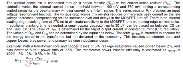

Hi Experts:
Customers want to know how to derive the fomula below and especially why is there a "2" here? Thank you.

Hi Skylar,
Rcs is basically calculated by Vcstmax/Ippk.
Whereas Ippk is calculated by the basic power formula Pout = (1/2) * Lpm* fsw * (Ippk)^2 *efficiency.
The 2 that you circled is reflecting the (1/2) from power.
Claire

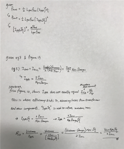

Hi Claire,
Thanks for your reply. I still have a question as below how to derive the formula?
Skylar
