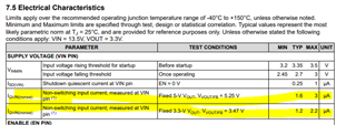

We are using LMQ66430-Q1 buck regulator.
Is it possible to provide Ibias of the IC?
It's required to calculate Iqvin at no load.

Hello
In section 7.6 they have given, for no load Io=0A.
But I am trying to calculate this value because we have to use same IC for 3.8V.
There is formula in 8.3.12. That Ibias value is required.
The answer you have given is same Ibias?
Can I use these values as I bias in calculation?
