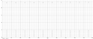

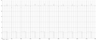

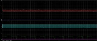

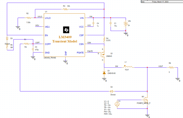

Hi Team,
I use the lm3409 to drive an LED. When switching off the PWM at the EN input, a falling curve occurs at the LED, which I cannot prevent. I have specially used a PMOS with small Qg.
Can you help me?

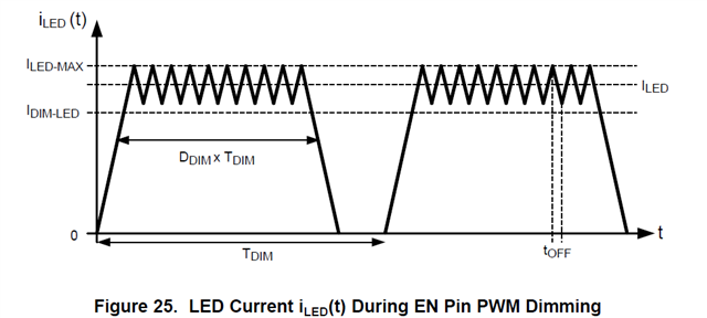

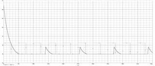

Thats the picture in the datasheet.

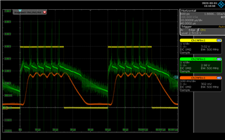

Thats my measurement (current (orange) 100mV/A; voltage output (green)
best regards.
