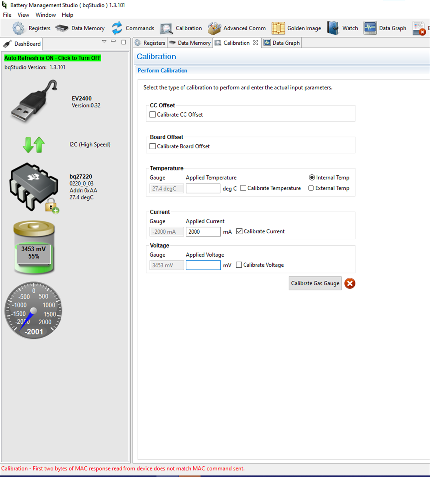

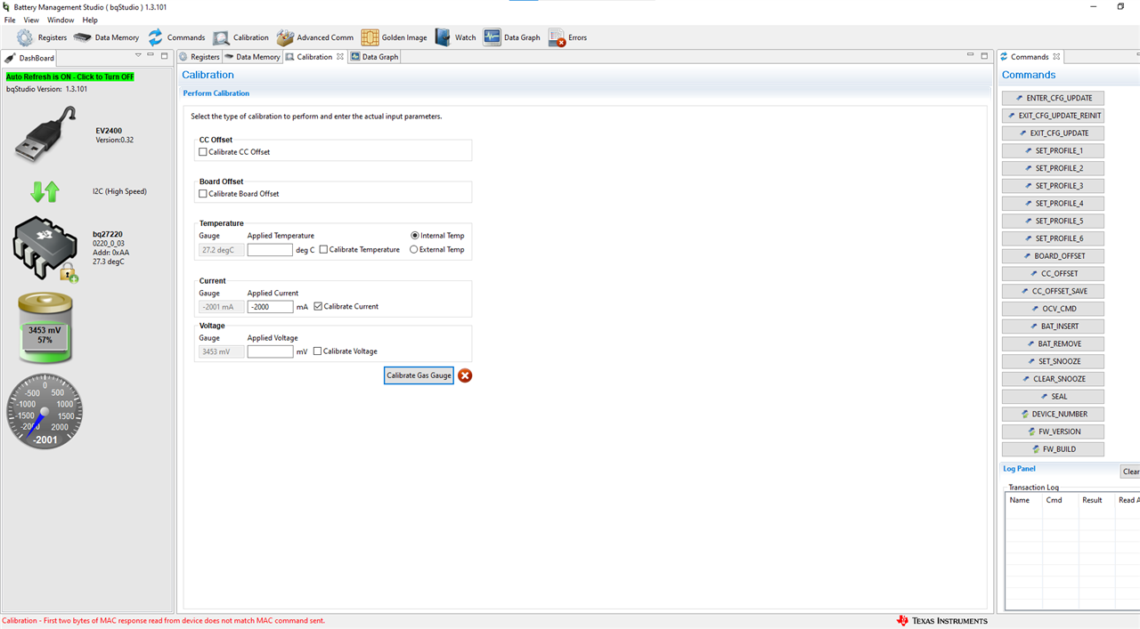

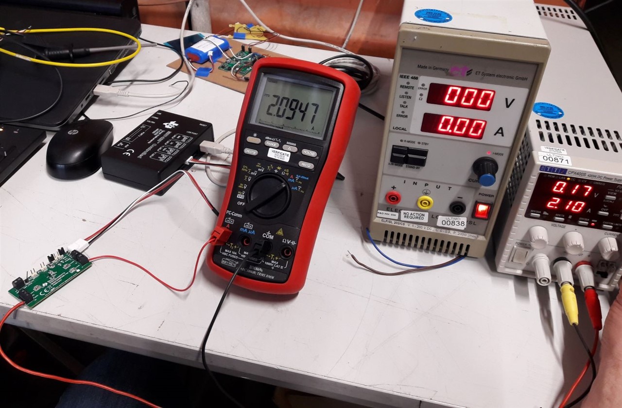

We are going to perform the calibration for BQ27220EVM via bqStudio (based on Section 3.3 in "sluubf5.pdf"). We have already performed the calibration of 'CC offset/board offset' and 'voltage'. However, we did not succeed in performing the calibration of 'current'. I have attached the screenshots of the calibration screen in bqStudio and also the photos of the hardware configuration we have used. Could you please let me know if you have any idea how to possibly make the current calibration work? Moreover, it seems that the calibration (of 'CC offset/board offset', 'current', and 'voltage') is not stored in non-volatile memory, right? Thank you in advance.
Kind regards,
Reza Ghaderi

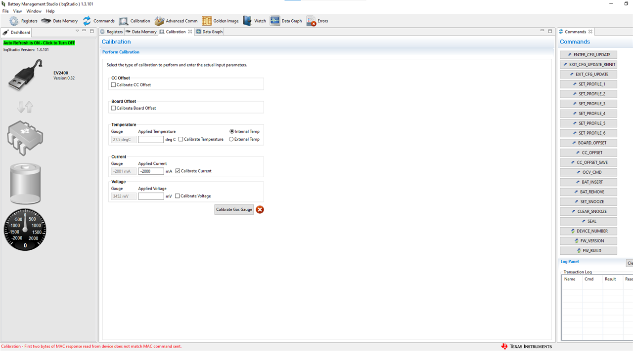

The above screenshots and photo are made based on the first option for the current calibration (i.e. "Connect a 2-A load to LOAD+/LOAD–") and the following screenshot and photo are made based on the second option (i.e. "or a current source to LOAD–/PACK–"). The second option did not make sense to us, but we did it for the sake of completeness.

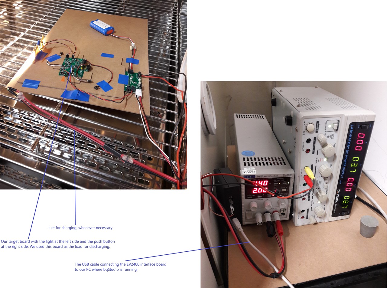

  • We made the measurement based on "sluubf5.pdf" and "sluub45b.pdf" for the average high discharge rate within the room temperature range using a climate chamber. I have attached the photo(s) of our setup and also the results of the measurement. Could you please let us know which row in the Excel file we could consider as the one that includes the termination voltage (e.g. row 4278 where the voltage is 2889 mV)? According to the battery datasheet, the discharge cut-off voltage for our battery (i.e. CHAM18650) is 2750 mV. Please note that the actual battery capacity is 5200 mAh (while you see 3000 mAh in the results).

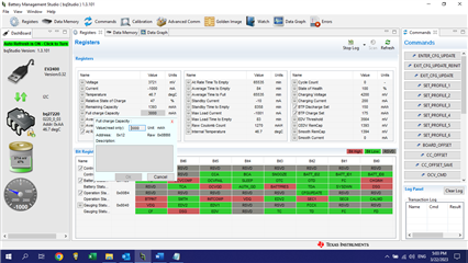

  • We attached an electronic load instead of our target board. Please find attached the results of our new measurement. As you can see in the results, the battery capacity is shown as 3000 mAh while the actual capacity is 5200 mAh. Consequently, we cannot see where the actual state of charge is 7%. Could you please let us know whether it is possible to change the capacity to the right amount (via bqStudio)? I have also attached a screenshot of the bqStudio interface where it seems impossible to change the capacity.
