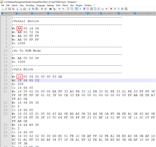

The bqfs file I exported from the bqStudio should have the following format:
“W: i2cAddr RegAddr Byte0 Byte1 Byte2…”.
So the first byte is the address. In the Data Block, it looks like the address changes. Is this correct or does this mean my bqfs has some issue?
