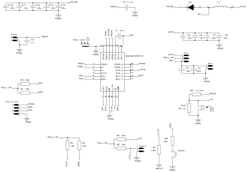

I have made a custom pcb with the bq25895 based on https://www.ti.com/tool/BQ25895EVM-664.
I have a 12V power supply connected to Vbus. I know I haven't shorted the D+ and D- pins. Ilim is configured with a resistance equivalent to 133 ohms.
I have read the FAQ file (Link) and I haven't found the error.
At this moment I don't have any load connected to Pmind or Vsys and even so it doesn't charge the battery.

  • Hi Raul,
    Thank you for reaching out via E2E and providing your schematic and register logs.
    Please see my comments below.
    -Are any of the components shown in the schematic not placed on your PCB? For example, there should not be two inductors connected to SW. Please help to provide an updated schematic which shows passive components populated on your PCB.
    -Looking at all 3 register logs it appears the charge state (REG0B bits 4-3) always reads 00b = not charging. Can you confirm that you are driving /CE pin low to enable charging.
    -The 3rd register log with a load on SYS indicates that the BATFET has been turned off (REG09 bit 5). You will not be able to charge the battery with BATFET_DIS = 1. Please make sure BATFET_DIS = 0 before you attempt to charge the battery. You may need to check your test setup if BATFET_DIS is being automatically set = 1 due battery protection feature.
    To continue with debug I recommend to continue testing with no load at PMID or SYS. Connect the battery first then VBUS and ensure /CE is low. At that point the register log should show an error if charge is not able to be started.
    Garrett
    Thank you for answering so quickly.
    1. Regarding the components, I followed the reference PCB schematic. On this PCB there are some components where it says DNP, I understood that these were optional and I installed them. The only one that I did not install is D3, it connects pin 22 with 21.
    2. I already checked this, just like on the reference board I put the /CE pin connected to the pull-up with a 10K ohm resistor. When I try to charge the battery, 2V circulates on that pin. If I use the jumper to connect it to GND it still doesn't load.
    3. As you can see, the design is almost identical to that of the reference pcb, after reviewing I have not found any differences.

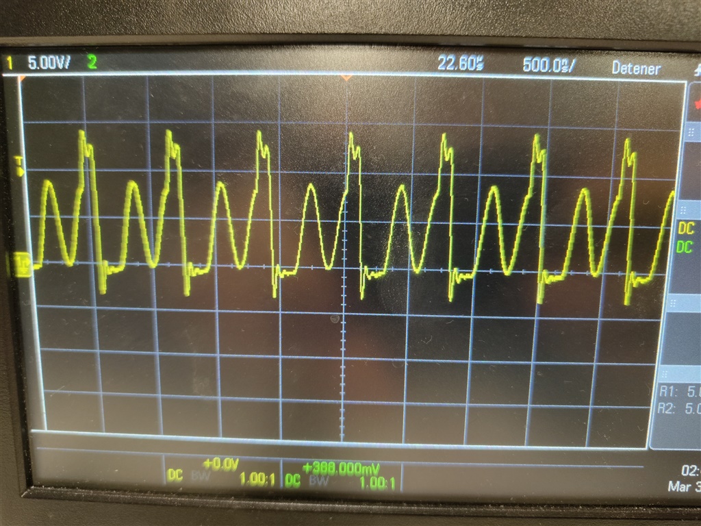

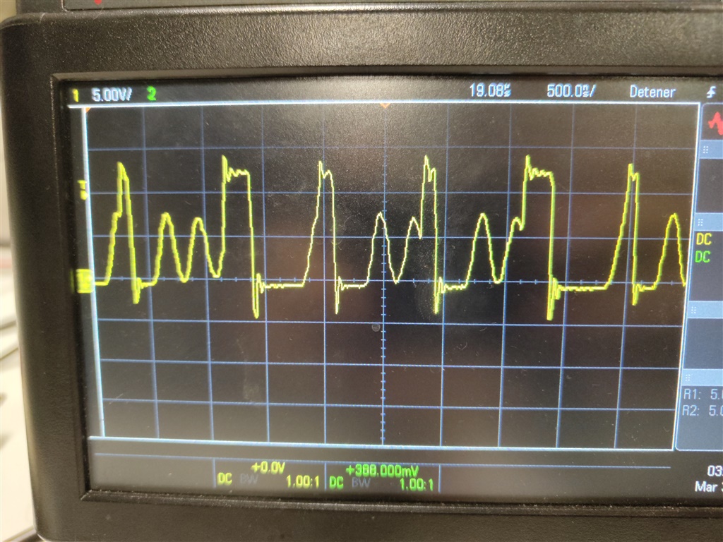

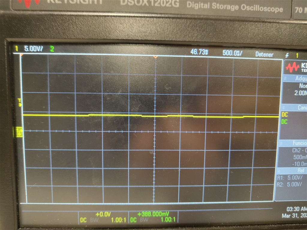

    have removed the DNP components and the others as you told me.
    I have done the test you asked me to do. You had not specified if the battery had to be connected, I have done both ways. always connecting /CE to GND.
    1) With battery
    Yellow - Vbus
    Green - Vsys
    The pcb is connected to a 12V and 450mA power supply. Using 3 multimeters I have measured Vbus (12.00V), Vsys (3.995V) and Vbat (3.996V). This doesn't match, the oscilloscope marks Vbus at about 4V and Vsys at about -4V.
    Also, measuring the current of the battery, it is discharging at -0.12 mA.
    2) No battery
    Everything behaves the same, but Vsys is not that stable, it has some spikes.
    Any idea what's going on?
    Thank you,
    Raul

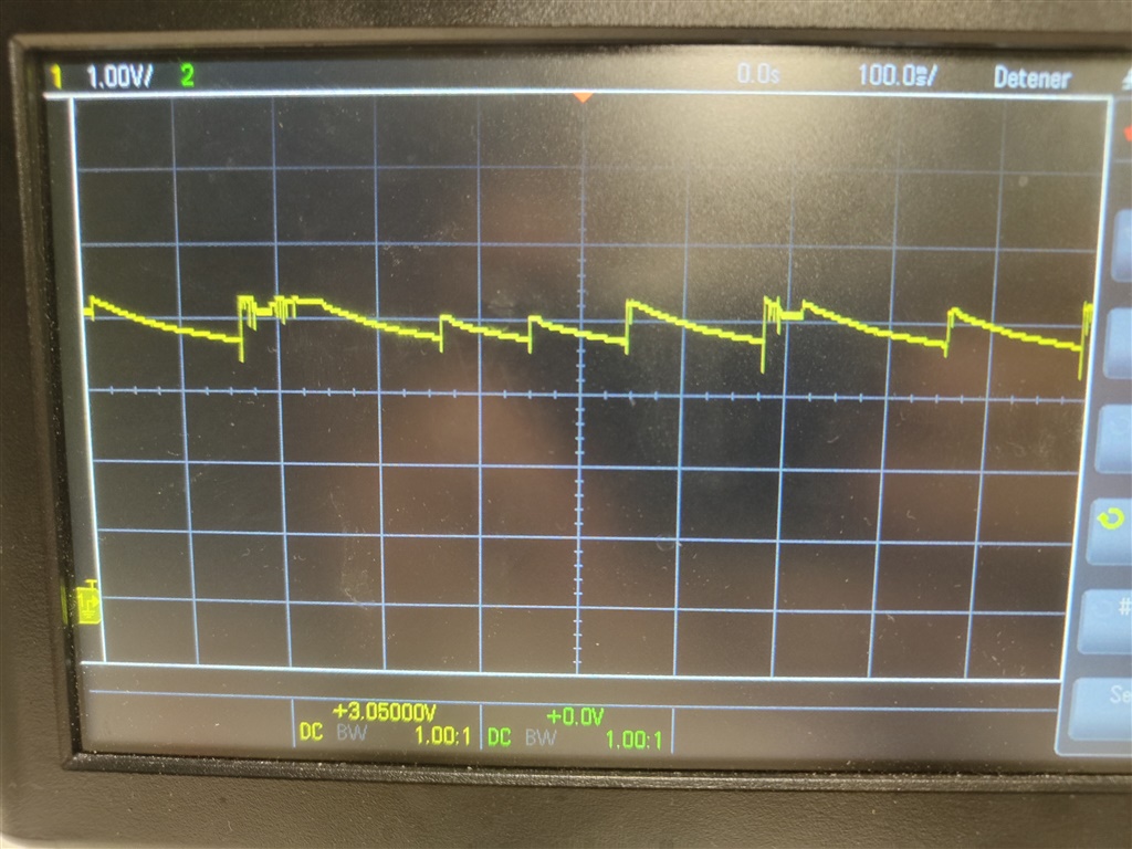

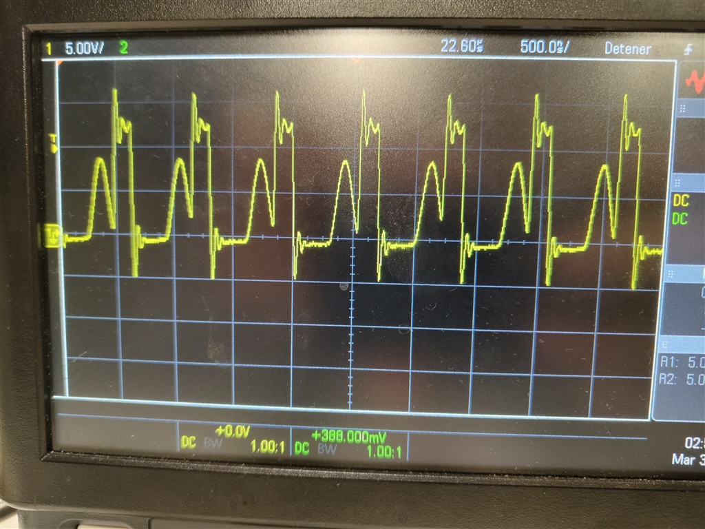

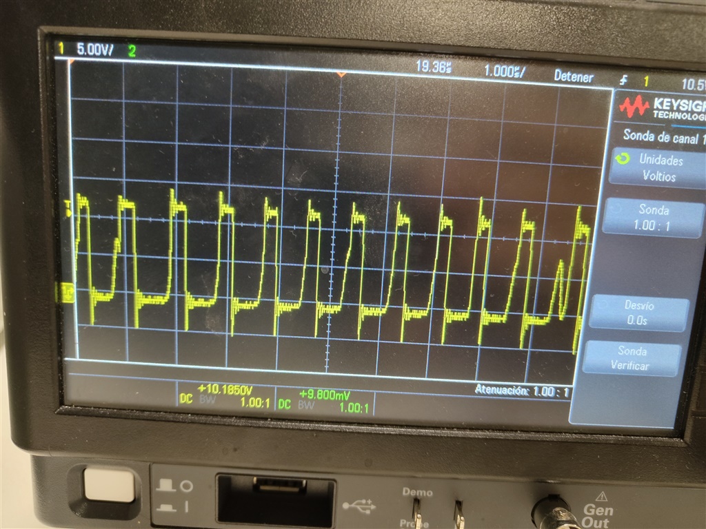

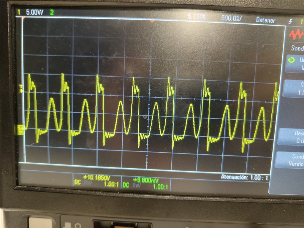

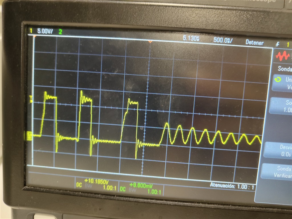

    I don't have the BQ25895EVM PCB, but I've repeated the tests and got better results.
    1) Vbus (yellow) and Vbat connected and the measurements are included (Vsys - green):
    Vbat is 3.995V
    Register log:
    Read REG 0x00: 0 1 0 0 1 0 0 0
    Read REG 0x01: 0 0 0 0 0 1 0 1
    Read REG 0x02: 1 0 1 0 0 0 0 0
    Read REG 0x03: 0 0 1 1 1 0 1 0
    Read REG 0x04: 0 0 1 0 0 0 0 0
    Read REG 0x05: 0 0 0 1 0 0 1 1
    Read REG 0x06: 0 1 0 1 1 1 1 0
    Read REG 0x07: 1 0 0 1 1 1 0 1
    Read REG 0x08: 0 0 0 0 0 0 1 1
    Read REG 0x09: 0 1 0 0 0 1 0 0
    Read REG 0x0A: 1 0 0 1 0 0 1 1
    Read REG 0x0B: 0 0 0 0 0 1 1 1
    Read REG 0x0C: 0 0 0 0 0 0 0 0
    Read REG 0x0D: 0 1 1 0 0 0 0 1
    Read REG 0x0E: 0 0 0 0 0 0 0 0
    Read REG 0x0F: 0 0 0 0 0 0 0 0
    Read REG 0x10: 0 1 0 1 0 1 1 1
    Read REG 0x11: 1 1 1 0 1 0 1 1
    Read REG 0x12: 0 0 0 0 0 0 0 0
    Read REG 0x13: 0 0 0 0 1 0 0 0
    Read REG 0x14: 0 0 1 1 1 0 0 1

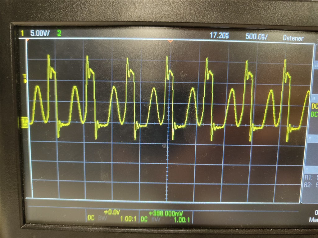

    SW signal:

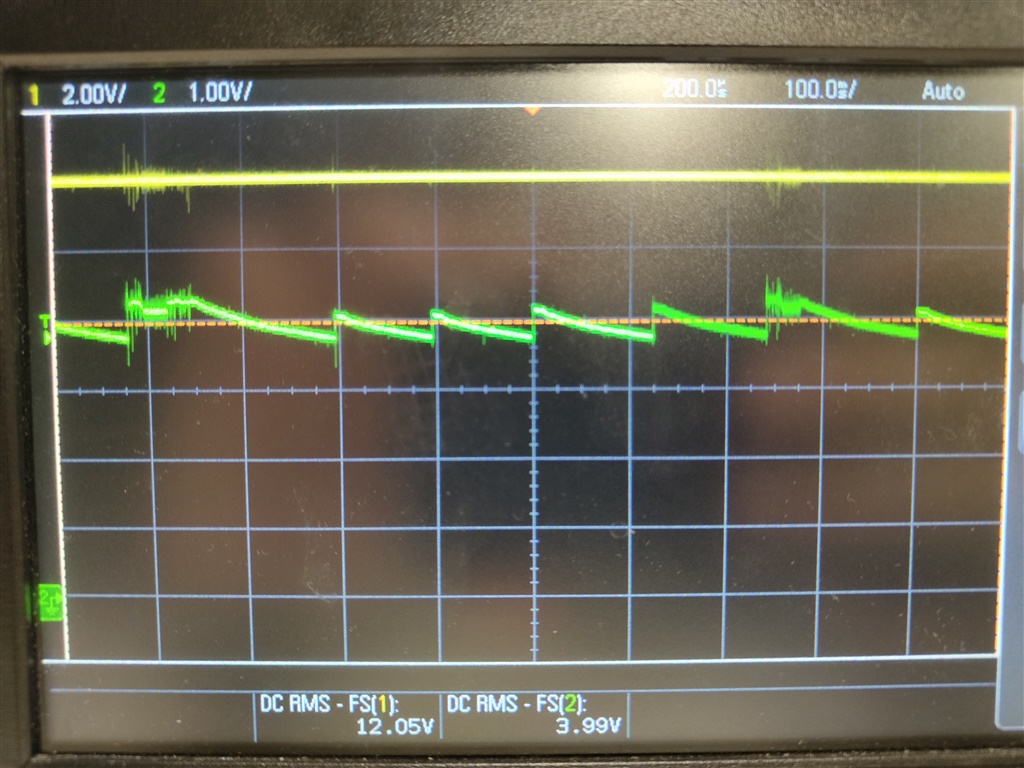

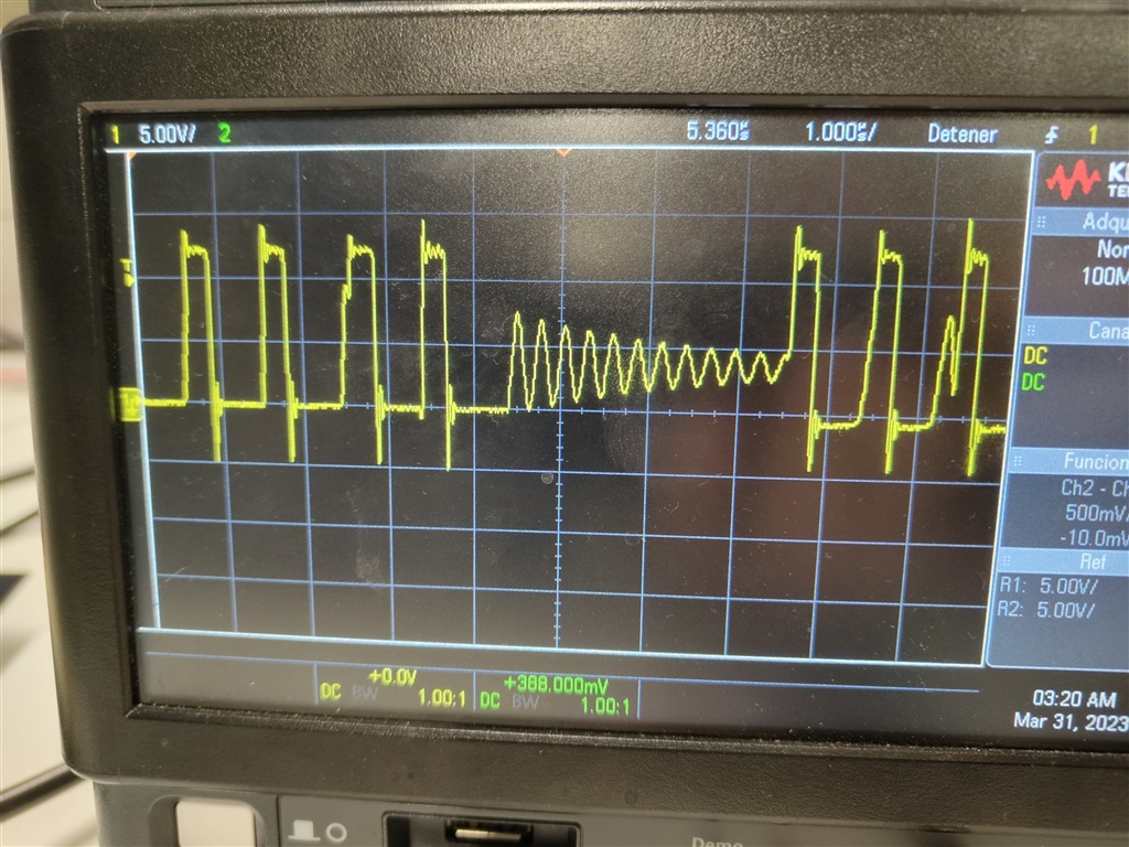

    2) Vbus (yellow) connected and the measurements are included (Vsys - green):
    Register log:
    Read REG 0x02: 0 0 1 1 1 1 0 1
    Read REG 0x0B: 1 0 1 0 0 1 1 0
    Read REG 0x0C: 1 0 0 0 0 0 0 0
    Read REG 0x10: 0 0 0 0 0 0 0 0
    SW signal:
    I hope it solves the confusion of the previous comment.
    But the battery continues to discharge.
    Raul.

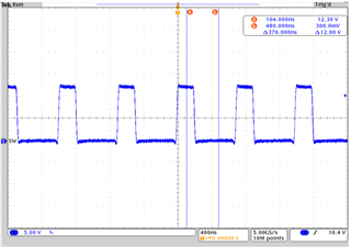

  • Hi Raul,
    The device continues to not work as expected. Based on the register log the device detects you input at VBUS, but does not correctly detect voltage at BAT pin or SYS pin. Not detecting the battery may be why charge does not begin. This leads me to believe there may be some issue with your board and there is a chance that caused damage to the device.
    Can you work to replicate a couple specific tests I will outline below.
    1)Test battery only operation through the BATFET. Only connect your battery and a load at SYS. Have the load be in the range of a 500 mA current draw. Then for registers leave all registers at default values other than turning off OTG (set REG03 bit 5 = 0b) and disable watchdog timer (set REG07 bits 5:4 = 00b). Then enable the ADC (set REG02 bit 7 = 1b) and read all registers.
    Below is expected register log when connecting VBAT = 3.95V. You should observe the battery discharge to SYS to power the load you have connected. Please provide the register log and multimeter measurements of BAT and SYS.

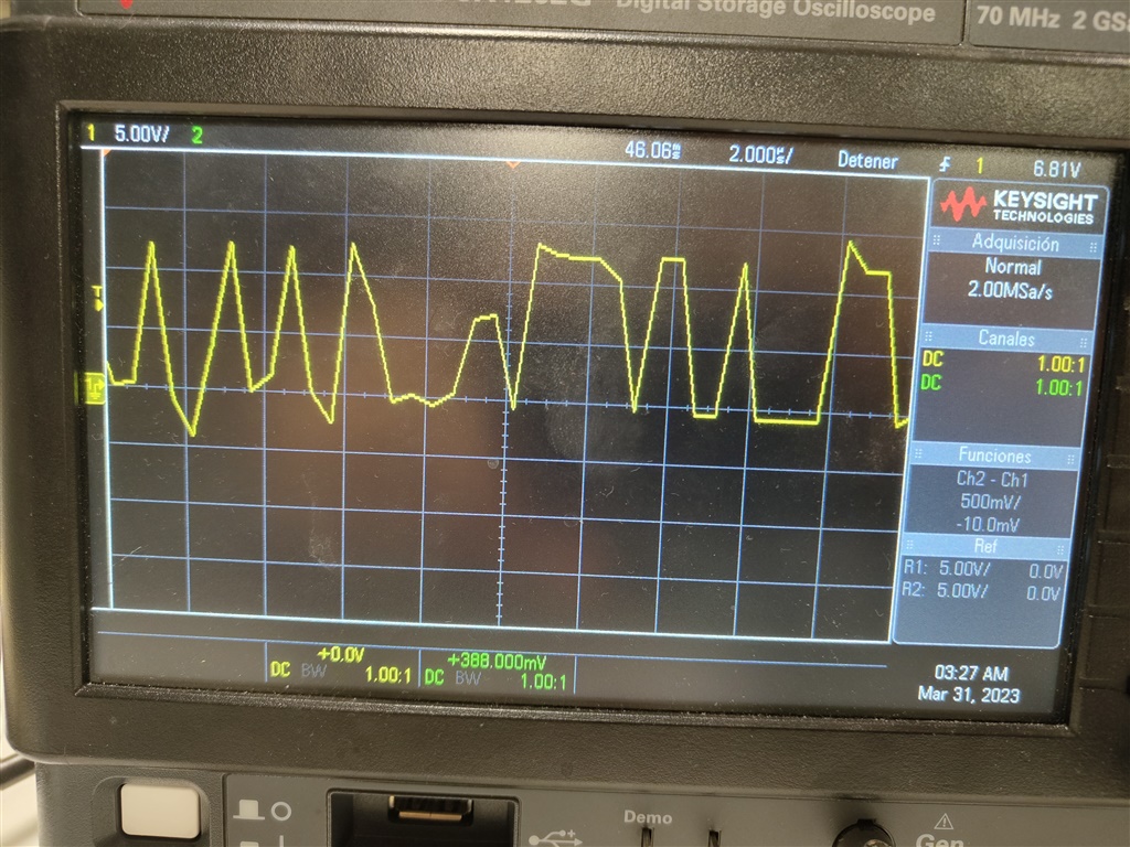

    2) Test SW node operation with charge disabled since you are currently unable to get battery to start charging.
    For this test do not connect the battery. Just connect your input power supply to VBUS and a load in the range of 500mA to 1A at SYS. Leave all registers at default values other than disabling charge (set REG03 bit 4 = 0b) and disabling watchdog timer (set REG07 bits 5:4 = 00b).
    Below is example register log. Depending on your adapter type the input current & voltage limits may be different, which is okay. Please enable the ADC to see if BQ25895 correctly detects voltage at VBUS and SYS.
    Please provide your register log, multimeter measurements at VBUS and SYS and an oscilloscope capture of SW node. I have provided a capture of what SW node should look like as reference.
    Garrett

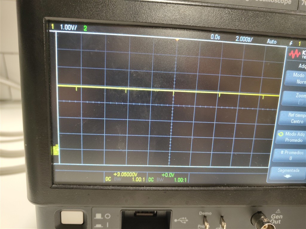

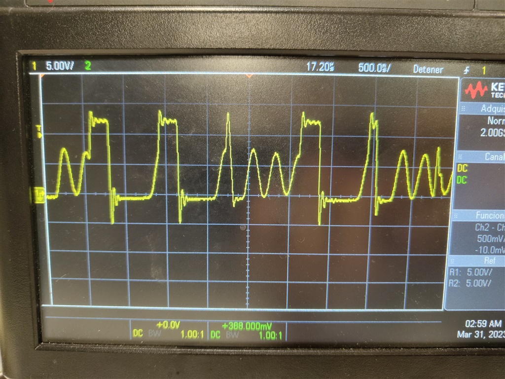

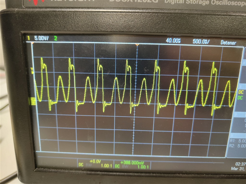

    2) Log:
    Read REG 0x01: 1 1 1 1 1 1 1 1
    Read REG 0x03: 0 0 1 0 1 0 1 0
    Read REG 0x04: 1 1 1 1 1 1 1 1
    Read REG 0x07: 1 0 0 0 1 1 0 0
    Read REG 0x0D: 0 1 0 1 1 0 0 0
    Read REG 0x0E: 0 1 1 0 0 0 1 0
    Read REG 0x0F: 0 1 1 0 0 0 1 1
    Read REG 0x11: 1 1 1 0 0 0 1 1
    Read REG 0x14: 1 0 0 1 0 0 1 1
    Load= 8.25 Ohm
    Vbus= 12.32 V
    Vsys= 3.98 V
    SW signal:
    3)
    Doing these tests we discovered that if the Vbus is between 5V and 6.1V the battery charges.
    Could it be because d+ and d- are connected as if there was a USB?
    Because it would be reducing the operating tensions of the USB protocol.

  • hi,
    After all the changes made to the pcb, we have the following schematic:
    We were using a battery with a voltage of 4.003V. This only charges with voltages from 5 to 6V.
    After having changed to a battery with a voltage of 3.445V, the board works correctly in the entire voltage range. Why does this happen?
    Charging the 4V battery, the SW signal is as follows:
    Zooming in on the part with noise:
    Charging the 3,3V battery, the SW signal is as follows:
  • Hi Raul,
    First, looking at your updated schematic it mostly looks good other than I do not understand the D+/D- connections. D+ is connected to net name 'PSEL', which I do not see anywhere else on the schematic. D- looks to be connected to STAT pin, which it should not be.
    If you are not using the D+/D- pins for USB BC1.2 detection please leave both pins floating or short them together.
    There should be no difference in acceptable input voltage between charging a battery at 3.4V and a battery at 4V. Based on your register logs the BQ25895 will charge the battery until it hits regulation voltage of 4.2V.  I would expect this difference in behavior to relate to the unique specifications of the different batteries/battery packs.
    To confirm that the switch signal is correct I need you to provide the waveform with the correct time scale. The BQ25895 switches at 1.5 MHZ. This means your time scale needs to be in the range of hundreds of nanoseconds per division similar to the example waveform I provided earlier in the thread. \
    Also to clarify the SW voltage signal needs to be measured between SW pin and the inductor. Your waveforms indicate that you observe negative voltage, which should not occur. The SW voltage should alternate between the VBUS voltage and GND.

    There was a mistake when representing the current schematic, attached the corrected version:

  • Hi Raul,
    Thank you for clarifying. Your schematic now looks good.

    I have found that if I put an ammeter between the battery and the PCB, it charges the battery between 100 and 400 mA. If I don't put the ammeter it doesn't charge.
    1) With ammeter (Vbus=12.4V Ibusmax=3.2A):
    Log:

    SW signal:
    2) No ammeter (Vbus=12.4V Ibusmax=3.2A):
    Log:
    Read REG 0x00: 0 1 1 1 1 1 1 1
    Read REG 0x09: 0 1 1 0 0 1 0 0
    Read REG 0x0B: 0 1 1 0 0 1 1 1
    Read REG 0x0D: 0 1 0 1 1 0 0 1
    Read REG 0x0E: 0 0 1 0 1 1 0 0
    Read REG 0x0F: 0 1 0 0 0 1 1 1
    Read REG 0x10: 0 1 0 1 0 1 0 1
    Read REG 0x11: 1 1 1 0 0 0 1 0
    Read REG 0x13: 0 0 1 1 1 1 1 1
    SW signal:
    Each time inserts a different number of pulses.
    3)I have assumed that it would be due to the resistance of the ammeter. I put a 10 Ohm resistor in series with the bar in front of the positive pole. this has reloaded.

  • Hi Raul,
    Regarding 1) The SW node waveform closely matches what is expected. Battery looks to be close to fully charged based on the ADC monitor. I would expect the charge current to increase to the 2A setting if you attempt to charge a battery that is only partially charged.
    Regarding 2) Similar to previous results you have shared the register log indicates BATFET_DIS bit is set to 1b (REG09 bit 5). I again ask can you confirm if this bit is being set by the BQ25895 on its own? This would indicate you may have an issue with your battery because the protection mechanism is being triggered. The SW node waveform matches expectation for operation with no output load. This makes sense because BATFET has been forced off to not allow charging.
    Why is the battery voltage so much different between 1) and 2)? Is the same battery being used?
    Regarding 3) The fact that connecting an ammeter or resistor in series with battery allows charge along with the BATFET_DIS bit being set when they are not present indicates there is some issue with your battery. I recommend you look into this further. When attempting to charge please try to clear the BATFET_DIS bit. Let me know if continues to be set by the charger device.
    If you have access to a source meter, such as a Keithley 2400, I recommend using that in constant voltage mode to simulate a battery and confirm the BQ25895 and your PCB work as expected.
    Garrett

    SW signal:
    8) I don't have anything similar to the Keithley 2400, but I have tried a new test. I have put a 100 uF electrolytic capacitor at the output of the battery to see if it tried to charge it or if something happened.
    Log:
    Read REG 0x02: 1 0 1 1 1 1 0 1
    Read REG 0x0B: 0 1 1 1 1 1 1 0
    Read REG 0x0D: 0 1 0 1 1 0 1 0
    Read REG 0x0E: 0 1 1 0 0 1 0 0
    Read REG 0x0F: 0 1 0 1 0 1 1 1
    Read REG 0x10: 0 1 0 1 0 1 0 0
    Read REG 0x11: 1 1 0 1 1 1 1 1
    SW signal:
    Intercalate 2 types of wave, in the first photo it looks more or less constant. In the second photo I interpret that this tries to charge the capacitor.
    - 1
    - 2
    I hope these tests serve to clarify the failures
