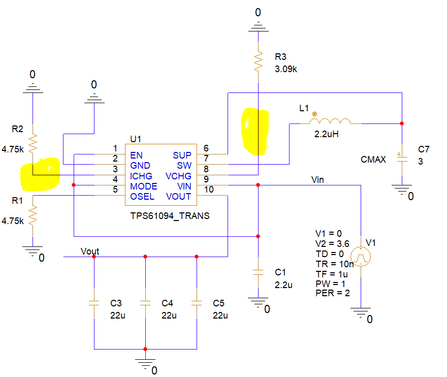

I'm having a problem simulating a TPS61094 Power Management Circuit. The error is caused by the two nets highlighted in yellow ( as shown in the picture below), N18339 and N18191.

Please delete the according line and re-draw to see if there is any change. It might be because the net is not correctly conneted.
**** 03/13/23 14:09:24 ******* PSpice 17.4.0 (Nov 2018) ******* ID# 0 ********
** Profile: "SCHEMATIC1-transient_analysis" [ d:\ashu\new water meter\ti\pspice for ti\projects\tps61094-pspicefiles\schematic1\tra

R_R1 0 N14777 4.75k TC=0,0
C_C1 0 VIN 2.2u TC=0,0
C_C3 0 VOUT 22u TC=0,0
C_C4 0 VOUT 22u TC=0,0
C_C5 0 VOUT 22u TC=0,0
L_L1 N14784 N14788 2.2uH
X_U1 VIN 0 N18746 VIN N14777 N14788 N14784 N19104 VIN VOUT
+ TPS61094_TRANS
C_C7 N14788 0 3
V_V1 VIN 0 3.6
R_R2 N18746 0 4.75k TC=0,0
R_R3 N19104 0 3.09k TC=0,0

ERROR(ORPSIM-15141): Less than 2 connections at node N18746.
ERROR(ORPSIM-15141): Less than 2 connections at node N19104.
Sorry for the delay. There may be some bug and I didn't find the root cause. Can I send you another 094 symplis and you can reedit based on the file?
Do you have the e-mail? I can't attached the file here. Firstly try to download from the ti.com again. If it still doesn't work I will send you this file.
Hi Nini,
I have tried it with the files you sent before, but it still doesn't work. the same error happens.
Is something you added ? I will send you pspice model. Please contact with me through e-mail.
Sorry about the delay. I was out of office. I can come to you through e-mail.
