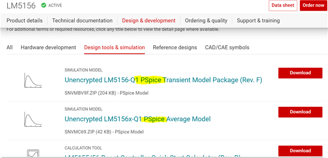

Hello Niklas
Thank you for your support.
Could you send me the original file of below pics?
As Niklas mentioned, all the TI PSPICE files can be downloaded from the following link: https://www.ti.com/product/LM5156#design-tools-simulation
