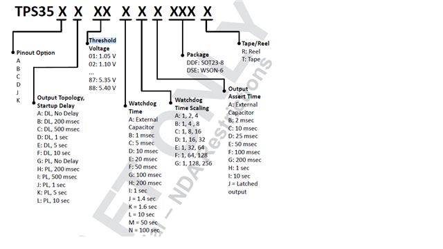

Customer condition is 3.3v application, the detection is slow and needs 50sec before the boot is completed The detection speed should be fast after booting up, please suggest suitable products What is the difference between startup delay /watchdog time /assert time?

    2. Watchdog time - This is the watchdog timer needed for the application after host boot is complete. The time can be set by external capacitor (pinout options A or B) or using fixed time option (pinout options C and D). The values are mentioned in the above image from datasheet.
    3. Output assert time - In case of error (either voltage supervisor or watchdog timer error), the output pin RESET or WDO will be asserted. The pin will be deasserted after a fixed time (for supervisor the time starts when supply voltage rises above threshold+hysteresis). The time can be set by external capacitor (pinout options A or B) or using fixed time option (pinout options C and D). The values are mentioned in the above image from datasheet.

    The model name should be TPS35CF58KAGDDF, its SOT23 C-type, 2.9vdc, 1.6sec watch dog time trigger and 200msec reseting pulse .
  • Hello Gareth,
    Thanks. Based 2.9V threshold, the part number will be TPS35CF38KAGDDFR.
    As you can identify, we can generate multiple OPN for this device. We cannot release all together. This OPN is not part of the initial release list.
    We can still work to arrange samples for you. Please reach out to local sales contact to arrange for samples.
