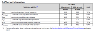

How to calculate the internal junction temperature of TPS746-Q1?
What is the thermal resistance RθJA, RθJB, RθJC(top) ?

    To calculate the internal junction temperature of TPS746-Q1, or any LDO, you must first calculate how much power you are dissipating. Power dissipation in an LDO can be calculated by the following equation:   You can use the value obtained from this equation to calculate junction temperature:  .  TJ is junction temperature, TA is ambient temperature and RΘJA is the device thermal resistance. Refer to section 8.1.6. in the datasheet or Semiconductor and IC Package Thermal Metrics for more detailed information.
    RΘJA is the measure of thermal performance of an IC mounted on a PCB. It is one of the only RΘJ parameters that assumes heat leaves through all sides of the package, thus is one of the easiest of the RΘJ parameters to use to estimate device temperature without board temperature.
    RΘJB is the junction to board thermal resistance, measured 1mm from a device.
    RΘJC is the top of case thermal resistance. It is defined as the thermal resistance from the operating portion of a semiconductor to the outside surface of the package. RΘJC assumes that heat leaves only from the top of the package.

    What is the value of RθJA, RθJB, RθJC(top) in TPS74601-Q1 EVM?

    RΘJA should improve 15-30% on the EVM.
    RΘJB is harder to predict, and we cannot say how this will change.
    RΘJC should not change depending on the board it is on as it is the thermal resistance on the top of the package.
