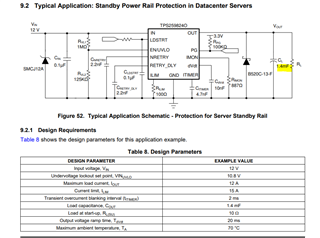

Hi
i need a out put capacitor calculation for this part.or can you please give the WEBENCH link,because i need to verify the differnt current level.
Hi
Hi Sathish,
Output cap value is dependent on your application requirement. We recommend small cap like 0.1uF for decoupling purpose. You can use PSpice model available on product page for evaluation.
Kunal Goel
in the typical application used 1.4mF for 12v,15A,but i need only 12v,6A ,so can you please tell the out put capacitor value.
Hi Sathish,
It is shown 1.4mF because that server application typically uses such cap. You should keep cap based on your application needs. You can skip using cap if not needed. You can just keep ceramic cap of 1uF. eFuse device does not need cap for its operation.
