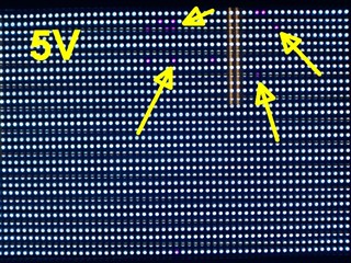

I'm developing an LED indoor display. I use matrix LED display driver type TLC59581. I use 4 drivers on one panel (connected in series).
The supply voltage of the RGB LEDs is 4.2V, and driver supply voltage is VCC = 5V (separate). I use a 4-layer PCB. My solution is very similar to TIDA-00161 ( https://www.ti.com/tool/TIDA-00161 ).
At small LED currents, everything works fine, but at high currents, some LEDs do not light up (check the picture). Iref=25mA, registers GS/BC/CC=max. The absolute maximum ratings parameters are not exceeded. VCC (5V) supply voltage checked with an oscilloscope - in no case does the voltage drop by more than 100 mV during operation.
If this problem occurs, then rewriting data and control registers doesn't help. I need to reset the power supply. Adding bulk capacitors for VCC/VLED doesn't help. LED open detection error flag is not set (read by loopback).
Where is the problem? What can I check?

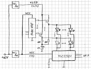

  • Some information. I send a simple block diagram and waveforms for VCC and VLED voltage (AC coupling in the oscilloscope) when I switch on/off all RGB LEDs.

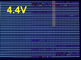

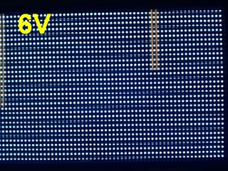

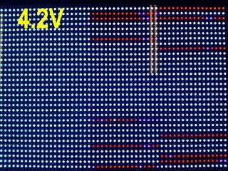

    Another test. I connected VLED to an external laboratory power supply and changed the voltage from 6V to 4.2V. Decrasing value of VLED voltage causes more LEDs to light off. Important - increasing the VLED again (and send new data) does not solve the problem. I need to reset the TLC59581 supply voltage (VCC).
    I have a feeling that the problem is in the internal structure of the TLC59581. For some reason, some analog part of this IC latches and stops working. Re-uploading the data/control registers does not help. Only on/off power supply. The problem is that there are separate supply voltages VCC and VLED.

    4. The left panel is powered from the higher voltage VLED and this problem does not occur. But high voltage causes too much heat loss...

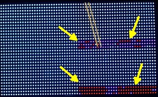

  • Hi Adam,
    I noticed that the LEDs which cannot be turn on is green/blue LEDs, which have higher forward voltage compared to red LEDs.
    And left half didn't have this phenomenon because it has higher LED voltage.
    So, I think it may caused by the voltage drop on routing and it triggered the LOD removal function.

    1) Too low voltage at the OUTx output. The TLC59581 needs about 0.5 V for the correct operation of the output current source. In my circuit, this voltage temporary drops to about 0.4 V, which causes incorrect operation. Adding bulk capacitors, using better MOSFETs, slightly increasing the VLED supply voltage solved the problem (+improving the PCB). Problem solved.
    2) When the LED matrix power supply (VLED) is too low, the output OUTx of the TLC59581 is permanently turned off (for a row). I understand that for too low voltage, the output current source does not work properly. But why after increasing the supply voltage (VLED), the outputs still do not work? Why is a power supply reset needed?

    Do you have any tips for using a Zener diode? In TIDA-00161 you use BZV55-C3V0 NXP (3V@5mA). In my circuit, for voltage <2.6V (measured on a diode Zener diode) ghosts appear. Can I use any lower voltage? Is it just power loss? E.g. simple rectifier diode with Vf=0.7V is ok?
    It is because you turn on LOD_Removal function, and LOD detection threshold default value is 0.4V. So the LEDs are disabled after detecting the open failure, even you set higher Vled it still cannot light up.
    Can I use any lower voltage? Is it just power loss? E.g., simple rectifier diode with Vf=0.7V is ok?
    Yes, you can choose lower voltage. The Zener diode is used to clamp the voltage on LED and quickly discharge each line when MOSFET is off.
    If the Zener voltage is set too high, the upper side ghosting would not be eliminated, if the Zener voltage is set too low, the LED will stand too high reverse voltage, which may decrease the life span of LEDs.
    I will suggest setting the voltage at the 0.6*VLED.
