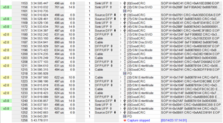

I implement TPS65988 as PD controller for our project, this PD controller will work with a single port TBT controller (Titan Ridge, TR) where its downstream is USB3.1 Gen 1 and upstream is TBT3.
In this project, I do not want to sink and source any currents to and from the host. So I set it as UFP (as I'm designing a TBT device).
I have encounter a problem where the PD controller does not communicate well with TR and prevent it from entering the TBT mode.
Questions:

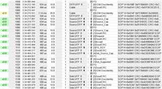

1. The below figure is the information I get with USB PD analyzer, and there is a command DiscSVID(NAK), may I know why I get this command?

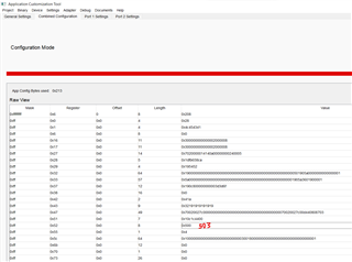

2. Which registers will take care on TBT mode entry?
Note: I have attached a link to my PD controller firmware setting project file.
drive.google.com/.../view
