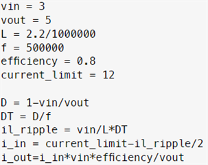

I want to know that the IC claims that it can deliver upto 2.1 AMPS of current ,can anyone please let me know the input and output for that?
my second question is  i am using 5000 mah 3.7v LI-ION battery I want 5 volt output what is the maximum current I can take from the ic? also the inductor value?
