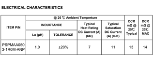

There is a 1uH inductor with a 11A/-30% saturation point.

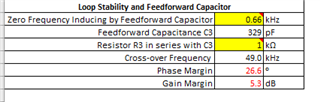

Due to a little overshoot on low current I added a 1k/330p feed-forward phase compensator. At very low current it regulates to 5.15v, then with any real load (>50mA) it regulates to 5V as expected. An oscilloscope inspection of the output showed it to be working correctly, clean (low) ripple.

  • Hi Andrew,
    If you worry about the stability issue, you can use the calculation tool in ti.com to check the stability. I think there is no need to switch compensation.
    Nathan
  • I've tried this tool and it won't allow me to change the feed-forward capacitor.
    I'm unsure if this is the issue or whether the chip is just notoriously unreliable. I've had many short over the development period for no obvious reason. Now that it's in production, a risk I onboarded for the very good specification it offers for supercapacitor usage, I find myself in a state or worry. It's also being used in another upcoming product. The products are expensive and non-repairable, a 5% failure rate would be unacceptable.
  • Hi Andrew,
    About the calculation tool, you can change the feed-forward cap by changing "Zero Frequency Inducing by Feedforward Capacitor" item.
    What is you max output current? I think 330p feed-forward cap is large for most of application conditions. Have you tried to remove this cap or try smaller one?

    Sorry that TPS61022 can't support 8A output current.
    The valley current limit means the inductor current, it is roughly equal to input current, not output current. (and for Boost, input current is larger than output current)
    With a large current, the output voltage will be much lower.

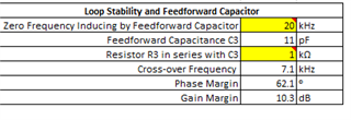

    I am getting somewhere. When the input voltage dropped to 1.86v and output was 673mA the output voltage increased to 5.25v, and that's with the cable voltage drop so I imagine it was circa 5.5v at the chip output. Unfortunately I didn't manage to capture the SW as the UVLO triggered, which means the ripples must be huge, 4.5v UVLO with 5.25v average must mean the peak is bouncing off the 5.6v limiter of the chip. So now I know the problem!
    It also blew some of the circuit, which I'll now repair and try to capture SW at a little less then the 673mA output.
  • I repaired the board and tried again. I set the current at 500mA output and watched the input drop, about 1.2v approx the output voltage rapidly went high, too fast to get a measurement on SW, and the input voltage from the super-caps very quickly dropped to 0.5v and the chip shut off.
    It's probably enough to go on. I'll await your recommendation.
  • I've now gone to 110pf + 1k and have a nice 500mA output sub 1V input, which is impressive. Best of all there's no overshoot as the voltage drops further and the circuitry has survived.

    Based on your description, it may be caused by instability. I check the stability by Calculation Tool, I find phase margin and gain margin are not enough with 330pF + 1k when Vin=1.8V and Iout=0.6A.
    even with 100p+1k, there is still some risk.
    So you need to reduce the value of Cff, for example, use 50pF
    You mentioned " I feel by adding the 330pF + 1k to correct the over-shoot at very low current", what do you mean of this? Do you mean the Vout would be higher at very low current? Thanks.

  • Hi Nathan,
    I managed to get 1A out at about 1.2v, I think this is nearing the max. Is 54pF still suitable?
    The original 330pF + 1k was suggested by you in another thread some time ago because without it when there's very little current the output voltage shoots up to 5.6v (it should be 5.0v). With the 330pF + 1k it's 5.15v. With the 110pF + 1k it's 5.10v.
    Andrew
  • Just for my understanding, if input voltage doesn't effect the phase, and current has some effect but not great, then what is the benefit in having a lower zero frequency? i.e why not just use 54pF if it covers all scenarios and be done with it?
  • 11pF is more suitable for 1.2V to 5V/1A. But you'd better to check the stability in other conditions (other current, voltage) with Calculation Tool in ti.com.
    About your question, input voltage and load current do have impact on phase. Generally the zero frequency is depended on specific operation conditions, it is hard to say the smaller the better or the larger the better. The decision of this Cff value is depended on the stability and transient performance you required.
    Nathan
  • I currently don't understand why one would target 2KHz as opposed to 20KHz or vice versa. Anyhow, 11pF at 1.2v/1A is unstable apparently...
  • About the output cap, you need to use the effective value not nominal value. I find you use 4x22uF cap, the effective value is usually approximately ~20uF with 5V DC bias. But you can double check in your capacitor datasheet.
  • I did derate but not by 50%. I can see that you are correct however, I need to derate a lot more.
    So ideally I need to increase output capacitance to the point that it doesn't effect phase that greatly, then choose the phase capacitor for the input/output voltage/current range. Without having a lot of output capacitance I won't be able to get stable phase across the range. Sound correct?
  • Actually no, if I increase output capacitance to something high like 470uF it's never stable.
  • OK from the tool 11-12pF + 1k looks to cover all the voltage/current ranges. I guess the larger the zero frequency the worse the transient response, however that's fine for this application. I'll build one up and have a test.
  • A further observation. With 12pF & 1k and a load of 2A I watch the input voltage of the super-capacitors drop. I can see through thermal the temperature of the chip rising. At around 1.35V input the overheat on the chip triggers. There's no damage. I don't expect 2A normally at 1.35V (it should be 1.5A peak) but did it to see if the chip would survive should the user connect an odd/faulty USB device.
    Voltage overshoot at very low current is 5.11V, which is fine.
    At higher input voltage of ~4V and 5V/2A output is no problem and the chip exhibits little heat on the thermal tool.
    So to my eyes 12pF is stable across all current/voltage levels.

    3. Many TI boost chips have minimal internal phase correction built-in, I see 12pF + 100k quite often. Does the TPS61022 have any and if so is it factored into the spreadsheet tool?
    The reason I ask (3) is two fold; firstly when I originally some years ago determined the 330pF+1k with yourself (I think it was) this was to deal with voltage over-shoot at very low current. Now I have removed the 330pF and found the over-shoot condition doesn't exist, so it appears to have been down to something else at the time (perhaps I since optimised noisy PWM traces away from the chip). Secondly, I have 1,000 PCB's to modify and it's a lot quicker to just 'smash' the 330pF 0402 off the PCB then to reflow a 12pF in its place. The spreadsheet tool doesn't calculate for no phase compensation though, so all I can do is test it on the bench, which I just did in (2) and it appears to be an improvement.
    If I run 100KHz + 100kohm the spreadsheet tool reports always stable at 1-5V input, 2A output, at 22uF effective.

  • Using the tool I have stability with 470uF and 220pF feed forward, the CPU can catch it. Otherwise there's the above method.
