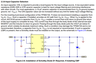

    For the TPS62913, it is not recommended to have a VIN-VOUT cap (sometimes called CIO or CBP) due to the stress it can cause on the VO pin.  If you find you need to use a CIO, it is recommended to use a diode across the output as shown in the following app note: https://www.ti.com/tool/TIDA-01457. The relevant section is shown below:
    I may include this in any updates I make to the TPS62913 IBB EVM User Guide, as this is not the first time this has come up.
    To change the output voltage to -1.6V, I would recommend that you leave the R5 value of 5.6k, and change R6 to also be 5.6k.
    For the FB location, moving the FB to the output of the ferrite bead filter will help with DC regulation over load conditions, but will not improve the high frequency spikes seen in Figure 2-2.  For the best stability, with a balance between output cap requirements and BOM count, I would recommend keeping the FB sense before the ferrite bead filter as configured on the EVM.

    I thought that TPS82130 IBB don't mount the CIO because the absolute max rating of VOUT is 0V.
    The ABS max rating of TPS62913 VO pin is -0.3V, but TPS62913 IBB still has the similar risk to get damage by CIO?
    Go
    Yes, the circuitry is similar for the VO pin and it has the same susceptibility.
