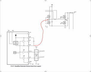

Whether necessary LM5177 SWX PIN connect to Both ends of inductor ,During use External Gate Driver。

Hi Xuan,
Thanks for using the e2e forum.
The first switch note (SW1) needs to be connected to the SW1 pin of the LM5177, the second switch note on the secondary inductor side (SW2) needs to be connected to the SW2 pin of the IC.
