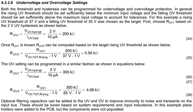

  • How can I set input voltage thresholds for a device start-up and a device turn-off?
    • Start-up: The TPS23523 starts up when the input voltage of nominal -48 V goes below -36 V.
    • Turn-off: The TPS23523 turns off when the input voltage of nominal -48 V goes above -32.5 V.

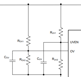

  • Figure 14 in the section 9.2 Typical Application shows two capacitors — COV and CUV — are put in parallel with the resistor dividers that set OV and UVEN thresholds, but what kind of effect will they bring to the system? In other words, what are the role of these capacitors in the application?

    Please place an appropriate resistor divider  network on the UVEN pin from RTN to VEE to select proper under voltage lockout threshold as per the system's requirement.
    Filtering capacitors, CUV and COV are be added to the UV and OV to improve immunity to noise and transients on the input bus. These should be tuned based on system requirements and input inductance.
