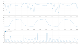

I'm seeing unstable SOC readings at temperatures below 0 degC. You can see in the attached plot that it starts to jump jump significantly depending on whether it is charging or discharging.
What could be causing this behaviour?

  •     From the plot, I can only see the SOC ramping up and down according to charging or discharging, per the scale of horizontal axis, it does not seem to be a sudden jump rather a SOC ramping up and down caused by charging or discharging.
       Maybe a log file could be more helpful for further inspection?
