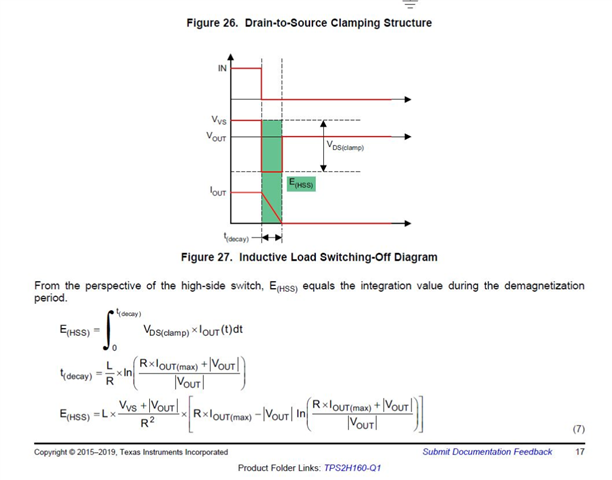

Hi Experts,
Seeking your assistance please:
We are using this High Side to drive inductive loads. During load turn off condition there will be demagnetization energy which will appear across the switch. In the datasheet (p17), there is an equation to calculate the energy:
Question:
How much energy can handle the high side switch? There is no information found in the datasheet.
Thank you.
