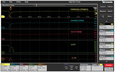

I managed to capture the following waveforms during a failure:
The following channels are used:
Channel 1 (yellow): IN pin of the gate driver, source of the MOSFET
Channel 2 (blue): OUT pin of the gate driver, drain of the MOSFET
Channel 3 (red): VS pin of the gate driver
Channel 4 (green): GATE pin of the gate driver
Math (orange): GATE-IN= gate-source voltage

I measured the following min./max. voltages with the oscilloscope:
IN-pin: min 4.144V, max 50.83V
OUT-pin: min 3.175V, max 50.69V
VS-pin: min 42.52V, max 50.8V
GATE-pin: min -490.6mV, max 52.72V
Based on the waveforms and minimum and maximum voltages, it is not clear to me why the IC dies.

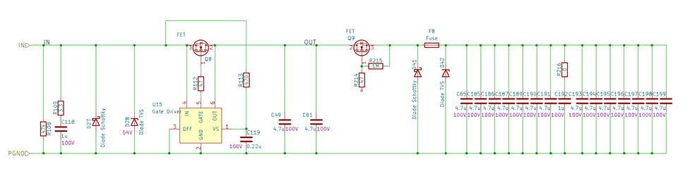

    Please share schematics for review.
    Is the output capacitor addition the only test you have performed ? This is to confirm if the IC failed during this test only.
  • I copy pasted the relevant parts of the schematics together from different schematic sheets. That's why there is no gate driver drawn for FET Q9. In the actual circuit it is controlled by an LTC7001 high side gate driver with charge pump.
    The IN-net on the left side is supplied via a ~3m cable with a 50V, 8A constant voltage, constant current source.
    Initially, we experienced 4 failures of this circuit, where we could not determine when exactly the circuit was damaged.
    Afterwards I could reproduce the failure 2 times while taking measurements. The behavior in both instances was the same and is shown in the scope screenshot I sent earlier.
    Based on these two failures, I expect that all 6 failures so far occurred during the transition I described above (this is an assumption).
    I repeat here the explanation of the transition with the schematic for clarification:
    Initially, IN and OUT are at 50V, the voltage drop across the FET Q8 is in the order of 45mV, indicating that the ideal diode circuit is working properly. The FET Q9 is off and the voltage at the right side of Q9 is 0V, i.e. the big capacitor bank is discharged. Then, the FET Q9 is turned on which causes the transient that is shown in the oscilloscope screenshot above. During this transient, the gate driver U15 fails such that GATE is shorted to GND. Afterwards the voltage drop across the FET Q8 is ~0.7V indicating that the ideal diode circuit is not working anymore.

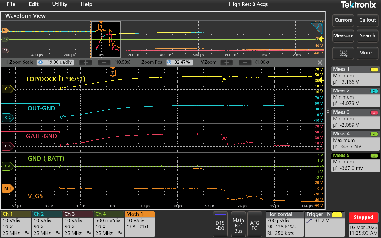

  • I could reproduce the failure once more and take some better measurements.
    Initially I triggered the transient 3 times or so and the part did not fail. Then I heated the PCB/IC with a heat gun to approx. 70°C and triggered another transient and the part failed immediately.
    Channel 1 is the voltage at the IN pin of the gate driver referenced to system ground.
    Channels 2 and 3 in this screen shot use differential probes to measure the voltages directly at the gate driver. (i.e. referenced to GND pin of gate driver)
    Channel 4 measures the voltage of the ground next to the IC (GND) compared to the system ground (-BATT). This system ground is the reference for Channel 1.
    In these measurements, negative voltage is visible at the IN, OUT and GATE pins of the gate driver. This could be the cause for the failure.
    However, I am not sure how this relates to 1) the apparent temperature dependency and 2) the fact that the gate driver only fails 100us after the negative voltage.
    Another thing that I don't fully understand is the "glitchy" IN voltage at the instant when the gate voltage starts to drop due to the gate driver failure.

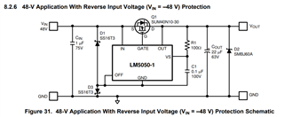

  • Hi Manuel,
    The device is failing as the minimum voltage rating of the device is being violated  when an additional capacitance is connected at the output.
    To resolve this issue,
    • Introduce inrush current control for reducing di/dt while charging the additional output capacitor. This will reduce the drop in input and output voltage to within the Absolute Maximum Rating of the IC
    • Add Schottky at the input which is capable of clamping the input voltage to within -0.8V during  charging the additional output capacitor.
    • Add a diode in the GND path (D3) of LM5050-1 as shown below. This will protect the controller from input negative voltages.
  • Thanks a lot for the explanation and the possible solutions! Have a great day!
