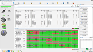

Dears,
    Could you help to review the alarm. no charge and no discharge. the OCC1 COV TCA Change to 1
     the use the default firmware
    Protections get set when the conditions outlined in the TRM are met. Please share your .gg file and a short log from your test.

  • Hi Wyatt,
        FYI

    5504.BQ40Z80.gg.csv
    The log appears to be the incorrect bqStudio log. The log I was referencing has all the data readouts from the gauge. On the main register pages click the "start log" button which will export all the registers every 4s by default. the bqSBB log doesn't show any state information from the gauge.
