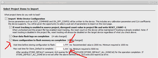

Two external temperature sensors are connected to rail 17 and 18 of UCD90320 respectively. we did added appropriate temperature calibration gain and offset. temperature readings also fine as expected.
Problem,
when we program the tifsp/xml to fresh and unprogrammed UCD90320 , temperature reading after programming successfully looks ok. but immediate next power cycle of UCD, temperature calibration gain becomes 1.3X automatically. and this value do not change again after any number of power cycles. But, if i re-write temperature callibration gain using "write to hardware" and "store to flash" using GUI after fresh programiing and power cycle, temperature calibration gain do not change again by itself to 1.3X and everything works as expected.
How to solve for this 1.3X automatic scaling when we program unprogrammed device ?
