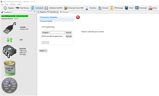

Hello everybody, I am working on my BMS card and I made a new version of it. I use Battery Management Studio to manage it and so i want to export the configuration of my BQ78350 from the previous PCB to the new one. But it's not working and I have some questions :
- First, I ordered the component from differents websites so I had some BQ78350-R1 and now I have some BQ78350, is it a software or a hardware version ?
- I tried to update the firmware but I can't click on the "Browse" button on the Battery Management Studio to choose the version.
- When I import my Data Memory from File I have 2 pop-up windows on my screen, are they errors or information messages ?
Thanks for your help

  • Ok thanks that's what it looked like to me. But I still can't click on the "Browse" button in order to choose the good firmware, on my software I can see this :
    John

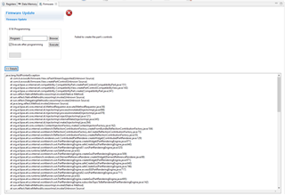

  • Hello John,
    Some files in the bqStudio installation folder are probably missing or corrupt.
    Delete/Rename the c:\ti\BatteryManagementStudio folder and reinstall bqStudio to resolve this issue.
  • Hello, of course I already tried, I did it again just in case, but nothing more happened.
    My error is:

    John
  • Hello John,
    Try this procedure to update the firmware
    Connect EV2400 but disconnect SMBus to bq78350
    Then start bqStudio and select BQ78350-R1 in the popup
    Navigate to firmware tab and see if you get the error. If no error, then connect bq78350 and program the R1 firmware to it from this tab.
  • Hello, thanks for the tips, it worked well. I will detail how I did if someone has the same issue :
    - Connect the EV2400 to the computer and leave disconnected the SMBUS.
    - Turn on the BQ78350.
    - Choose the first version of the BQ78350_R1 on the BQstudio pop-up.
    - Go on the Firmware section and select your BQ78350_R1 firmware.
    - Click on "Program" and connect the SMBus to the EV2400.
    Have a great day.
