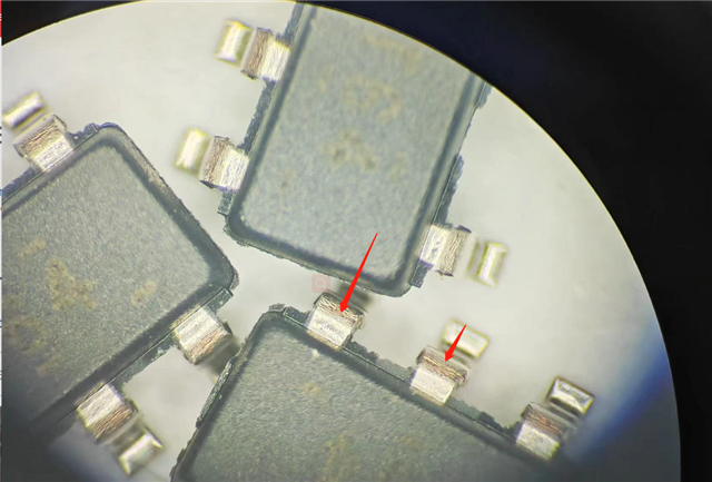

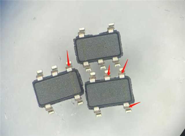

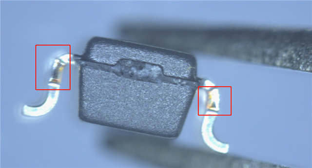

There is copper leakage in the pin position of this material. Our company believes that it will lead to oxidation after use, which will further affect the performance. Please help to check whether this material can be returned

Let me see what we can do. Is it possible to get a better image? it is really hard to tell that there is any copper being exposed from the pictures.
Edgar Acosta
Thank you for the pictures, this will help us from our end.
I have already started the conversation internally. Overall, there should be some inspection and acceptance once the device gets assembled.
As of now, can you give me an estimate of inspected devices on your end? Is it only those 3, or is it the entire order? In addition to this, can you share a picture of the label or the LOT # that way we can track down the material.
