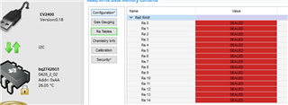

3、According to TRM, we understand that BlockData() can be read in the Sealed state. But the actual operation, the value read is 0xFF, the value of DataMemory in the studio is SEALED. see the figure below.
If Sealed state, how to read the data in DataMemory?

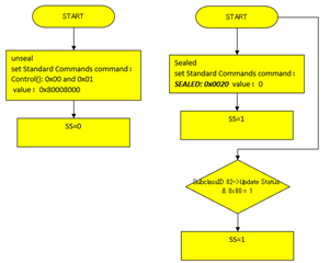

4、After executing unseal operation ( Control(): 0x00 and 0x01 --> 0x8000 8000), will Fuelgauge stay in unseal state without sending 0x0020 command?
5、Is the flow of set/clear about CONTROL_STATUS -> SS tag correct? See the flow chart in the yellow part of the figure below.

    #3: The gauge will not return valid data if you read DM while the gauge is sealed.
    #4: The gauge will stay unsealed after you unseal it until you seal it again.
    #5: This looks ok.
    #6: Yes, the data will still change but it can't be read via I2C until you unseal the gauge.
