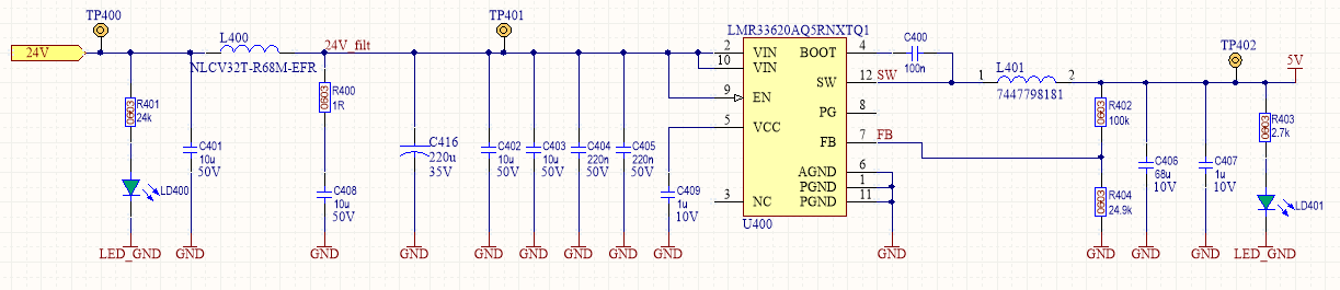

My LMR33620ARNX is switching at 140kHz with SW high 99.5% of the time. So Vout is close to Vin and FB is kept at 3V (when Vin=15V).
Is the device broken or is there another explanation?

Hi Torbjorn,
Thank you for using our products. It sounds like the IC is compromised somehow, and the circuit is operating in open loop. I do not see nay obvious problem from the schematic.
Could you replace the IC and re-test? Please make sure the IC is handled carefully without being damaged by ESD and/or overheating during soldering.
