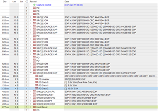

Comparing the evaluation board with the communication section, it does not work because Hard Reset is executed.
Checking the GPIO with an oscilloscope, it remains Low. Reading the 0x5C register with I2C confirms that it is changed.
I am assuming that a hard reset is taking place because I am not getting 15V voltage, but I don't know why a hard reset is taking place, so please advise.
