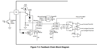

We’ve got questions on UCC256402’s external shutdown feature. Would you please take a look below, and provide answers?
[Q1] To enable external shutdown, I believe FBreplica should be less than BMT (FBLessThanBMT). How can we determine this BMT value? Is there a way to measure this value, or can we calculate it numerically?
[Q2] To enable external shutdown, FBreplica should be lower than SSreplica as well. How this SSreplica determined? Is it 3.5V fixed continuously, or the min is fix to be 3.5V?
[Q3] Related to Q2, does BLK-voltage affect SS-voltage? From functional block diagram, it looks independent.
    1. You need to pull down the BLK pin for external shut down. Pulling down FB pin is not recommended. External resistances connected at the LL/SS pin and BW pin determine the BMTL/BMTH thresholds. Please see the datasheet for additional details
    2. After soft start, ss pin voltage will be at 3.5V which is higher than BMTL/BMTH thresholds. So No need to pull down SS pin voltage for external shut down
    3. BLK pin voltage doesnt impact the SS pin voltage. As soon as BLK pin voltage reached BLK start threshold, soft start will be initiated.

  • Why is it not recommended to pull down the FB pin?
    The EVM application of this device has a circuit example of remote ON/OFF by this FB terminal operation.
    Learning from this, I am thinking of stopping the device output by sinking the FB pin.
    The reason is that stopping the operation by pulling down the BLK input does not satisfy our power supply system function using this device.
    After the FB pin released, the controller might trigger the OCP since reference voltage is different from the current output voltage of the converter. Where as if you release the BLK pin, the controller will go into soft start mode where controller currents will be gradually increasing.
    If the FB terminal can be used for remote stop operation, is it necessary to clear the BMTL/BMTH threshold as a stop condition?
    If so, is the threshold derived from the value of the external resistors connected to the LL/SS and BW pins?
    You commented that the calculation of the threshold is based on the data sheet, but from which formula can it be calculated specifically?
    Fbreplica signal which is inside the controller has to go below BMTL threshold for the switching pulses to be off.
    Please see the section 2.6.3 of the app note for calculating BMTH and BMTL thresholds: https://www.ti.com/lit/pdf/sluaaj7
    With our prototype EVM board, the device was stopped by a sink operation with an FB voltage of about 3V.
    However, based on the theoretical derivation based on the calculation results, if this stop threshold is even lower, is it possible to stop by series sink operation of thyristor + diode (sink voltage operating value ≈ 1.3 V)?
    Its not voltage at the FB pin that decides turn off. Its the current thats being pulled from the FB pin that will decide the fbreplica magnitude. Please go through section 2.3 of the app note for clear understanding: https://www.ti.com/lit/pdf/sluaaj7

  • Also, I know the FB terminal is controlled by a current sink, but I wanted to know at what volt the voltage would stop when the FB terminal finally pulled.
    When you Pull the current more than( IFB source plus clamp current ), vfbreplica will be below 0.2. This would make the controller stop switching.
    Also, some answers say "ZCS protection is disabled if Fbreplica is lower than his BMTH", but I don't think there is any feedback control that would make this voltage he below 0.2V in normal operation. Therefore, during normal operation he believes there are no conditions to disable ZCS. This time, setting his FB pin pull-down by IC external operation to the stop level that interrupts his BMT threshold disables his ZCS operation inside the device. However, since the device output shifts to stop mode at this time, it is judged that disabling the ZCS operation does not affect operation.
    Is there a problem with this idea?
    When you stop switching, you dont need to worry about ZCS.
    f an error occurs in normal operation, what is the response time from signal input operation to device output stop in the two methods of "stop operation from the BLK pin" and "stop operation by FB pin sink"?
    Also, which one reacts faster?
    Also, how many μsec is the difference in response time between these two actions?
    Both reacts faster. I would assume there are internal delays of the comparators which will be very very small. We don't have this data in Datasheet. So, I cant provide this data.
