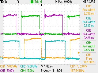

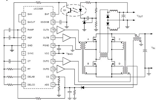

  • Hello Mike,
    I also have the same problem here.
    UCC3895 is configured as voltage mode.
    A resistor from Vref to RAMP (Pin3) and capacitor from RAMP to GND.
    CS (Pin12) is not yet connected to the CS of the sense resistor.
    Here are the waveforms I get.
     OPEN LOOP
    Ch1 = OutC (Pin14)
    Ch2 = OutD (Pin13)
    Ch3 = OutA (Pin18)
    Ch4 = OutB (Pin17)
    CLOSED LOOP (NO LOAD)
    CLOSED LOOP 1/4 LOAD
    Here is the basic sch i made except for RAMP resistor to REF pin.
    The ill effect will be for the pulse transformer being not balanced due to different volt-second for OUTC and OUTD.
