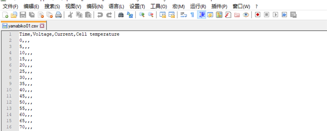

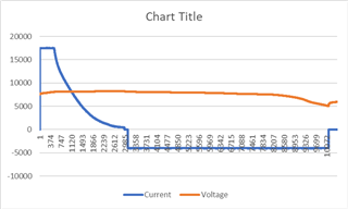

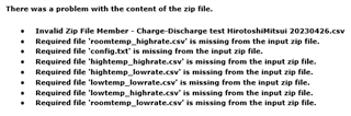

I am designing a fuel gauge for second-hand car battery with BQ34Z100-R2.
The battery module is composed of 2P2S cells, and the chemistry of positive electrode is LiMn2O4 + LiNiO2.
Would it be possible to create a ChemID for the battery module if submitting the required data files?
Thanks in advance,
