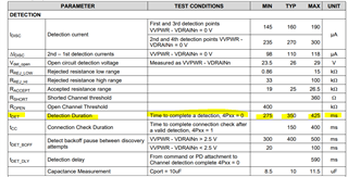

    Regarding the Detection_Time_Tdet, the TPS23881 has a range of detection duration as highlighted below:
    This parameter is non-configurable and the PSE device should always follow this, assuming there's no issue from the hardware or firmware.

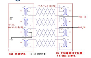

                   According the picture,as working a BT mode,the TPS23881 'S 1-2 pair are connecting the transformer centertaps of net 1-2 and net 7-8 in the RJ45 connector.Is there any suqence request that the tps23881's 1 port must connect to the net 12 of RJ45 connector and the  tps23881's 2 port must connect to the net 78 of RJ45 connector. Can we change the sequence?
                 Also ,do you find some problem in the PCB layout?
                 Thanks.

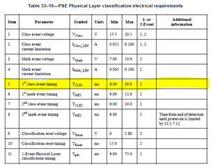

    When the BT ports are tested using the AF/AT test, a failure is to be expected. BT standards for testing are different than AF/AT standards because BT standard devices have a different Maintain Power Signature (MPS) than AF/AT standard devices do, and the Sifos tests use this MPS to help determine pass or fail.
    Nate
  • Hi Nate,
             Why some BT ports can pass the sifos AF/AT test,some BT ports can not pass the test. Also the BT port can use as the AF/AT port ,the protocol is compatible.If we want to pass the sifos AF/AT test, how to test?
               Thanks .
  • Hi Jingjing,
    Due to the differences in first class event timing, BT devices should not pass AF/AT tests. (first image from BT standard, second image from AT standard)
    It is true, BT standard devices are backwards compatible and can operate as AF/AT devices, but the Sifos tests are designed to work only with the devices that their standards correspond to. A BT device cannot pass an AF/AT test.
    Nate
  •       According the picture,as working a BT mode,the TPS23881 'S 1-2 pair are connecting the transformer centertaps of net 1-2 and net 7-8 in the RJ45 connector.Is there any suqence request that the tps23881's 1 port must connect to the net 12 of RJ45 connector and the  tps23881's 2 port must connect to the net 78 of RJ45 connector. Can we change the sequence?
         Also,we change the sequence in the sofeware,then we have a sifos AF/AT test,the result is not same.We ask our software engineer,they say there is the sequence.
        Then I want to know what is the right sequence.
         Thanks.

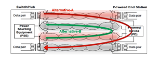

  • Hi Jingjing,
    There must be a channel to send power and a channel to receive power. It is standard for channels to be set up this way.
    The signal over Alternative A will be sent slightly earlier than the signal over Alternative B, so if they are swapped it is expected that the results would not be the same. However, results from AF/AT Sifos tests on BT ports will not be valid in either configuration.

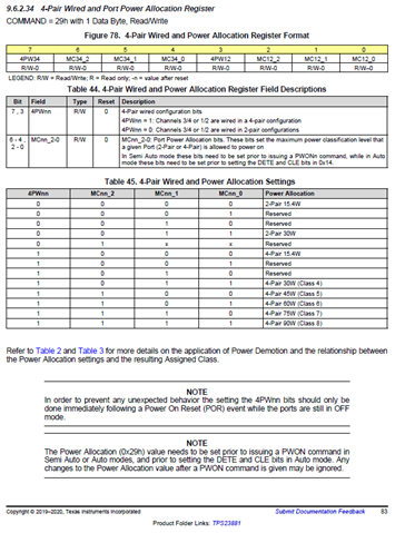

  • Hi Jingjing,
    You won't need the port remapping, but you will need to use the 4-Pair Wired and Port Power Allocation Register, register 0x29.
    This register sets whether the channels are in 2-pair or 4-pair configuration.
    Nate
  • Hi Nate,
             Now the value of register 0x29 is 0xFF.I want to know when we need to have the port remapping?
             Also when we have a sifos BT test ,do we need to have the port remapping and is there anything need to set in the software?
             Thanks.

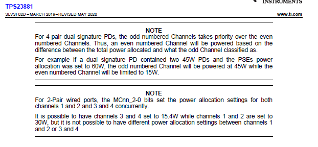

  • Hi Jingjing,
    For port 44, try remapping channel 3 to channel 4 and channel 4 to channel 3. Odd numbered channels get priority, so it may cause some issues for the test if channel 3 is used for Alternative B.
