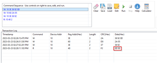

I'm working on reading and writing values to the BQ data memory and subcommands over I2C, working primarily from the SLUUBY2B TRM and the code example provided on the part page. I have a few questions:
1 Is there a way to check the subcommand and data memory checksum on reads? 13.1 of SLUUBY2B describes a method for doing it, but there's no code that performs the checksum for reads in the example, and I have so far not gotten the same result from my locally computed checksum as the one reported by the BQ, though the data appears to be coming back correctly, and the subcommand and data memory writes seem to be successful.
