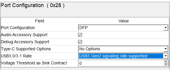

   A USB SSD that can be accessed with USB3.2 Gen2 is connected to the USB Type-C port of the TPS65987. However, it only connects with USB 2.1.
   The same is true for the TPS65988EVM EVA board, and USB3 Event is set to GPIO6, but it does not become active even if the device is connected.
Could you please confirm which setting is the problem?

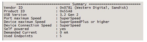

    2. Confirming the device information connected via USB on a Windows or Linux computer.
    For Windows, free display software is used.
    Even if a SanDisk SSD (USB3.2 Gen2) is connected, the USB Version will be 2.1 as shown above.
    If not through EVM, it will be recognized by 3.2Gen2 normally as shown below.
    On a Linux machine, you can check the connection with the lsusb command, but it is a USB2 connection.

    The following three GPIOs are wired from TPS66587 to TUSB546,
    Since GPIO6, which indicates USB3 connection, is not activated, the TPS66587 does not recognize it as USB3 in the first place.
    When the aforementioned SSD is connected, it becomes active for a moment and the LED lights up (for about a few seconds), but it goes off immediately.
    Is it canceled even though it was recognized for a moment?

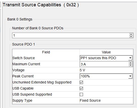

    1- Yes there is a parameter to set the overcurrent protection in the GUI. You can change the 'Peak Current' percentage in Transmit source/sink capabilities.

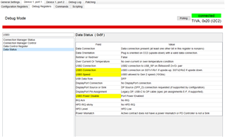

    2- I would highly recommend reading into the Data Status register in debug mode to see which USB speed the PD is recognizing (see image below).
    Could you please do this and let me know the results you find?

    Finally, It was improved by checking the following USB Capable.
    Please tell me one last thing.
     What does "USB capable" enable?
     TPS65987DDH and TPS65988DH Host Interface Technical Reference Manual (Rev. B), P40, TX Source Capabilities Register Bit
     Byte12 changed from 0x01 to 0x05.
     It says First Source Capabilities PDO contents Bank 0. What signal is assigned?
    Even if this setting was reflected on our board, USB3 was not enabled, but when the TPS65987 detected OverCurrent, the OS restricted the USB speed.
    After disconnecting the OverCurrent interrupt signal and checking the connection, it was recognized as USB3.
