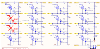

Hi team,
I am using BQ76952 BMS IC. I have opted for external cell balancing and the system is working as expected. While verifying the system, I found out that cell 16 is not getting balanced but it is showing high in cell balancing active cells register (8AAA {hex} - 1000 1010 1010 1010 {decimal}).  When I measure voltage across external resistor of cell 16 it is 0V; but when I measure voltage across 2,4,6,8,10 and 12 it is 3.8V and it is working as per design which is 150 mA. The configuration setting is max 8 cells can be balanced. Start delta relax is 10 mV and stop delta relax is 5 mV. Please assist me in resolving this issue.

    Please share your schematic.

    Measure the voltage across Rbal (R5) and also across VC16-15 pin of the FAE. The voltage will drop across the VCx pin if cell balancing is active.
