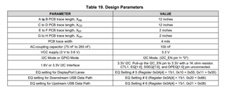

I can not understand how to set EQ via register by reading datasheet.
EQ setting for Upstream USB Data Path: EQ Setting # 6 (Register 0x0A[4] = 1'b1, 0x21 = 0x08)

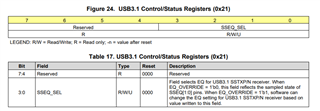

When 0x21=0x08, why EQ setting=#6.
Besides, the register value is only 0~7,  how can we get the Equalization setting #8~#15.
