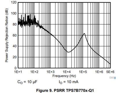

Hello Experts,
Customer would like to know PSRR data as Figure 9 in datasheet. The condition is Io=100mA, Co=2.2uF(same as spec).

Hi Fujiwara-san,
I can try to get this data in the lab this week for you.
Vin = 14V is ok?
What VOUT would you want.
We would expect with higher IOUT and smaller COUT that the PSRR will be slightly lower than what is depicted in the datasheet figure.

Hi Fujiwara-san,
I've been testing it all today, but I'm having trouble reducing noise and erroneous spurs in the measurement itself causing the graph to not be nice enough to share out with customer, specifically relating to inductance on the cables as I am using an EVM, and have to introduce inductive clips and cables in order to take the measurement.
However I can tell you at rough approximations of the rejection ratio at some points along the curve for the portions of the curve that the parasitics have not affected
10Hz - 70dB
100Hz - 72dB
1000Hz - 63dB
10000Hz - 30dB
100kHz - 52dB
1MHz - 22dB.
The rest of the curve I do not trust to be representative of the LDO's actual operation.
