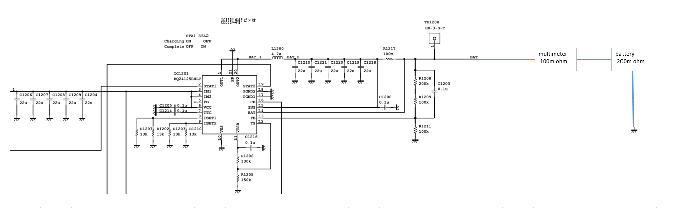

The customer states that STAT1 repeatedly turns on and off in approximately 1.2 second cycles while the battery is charging. The following information has been confirmed by the customer to date.
- The battery current changes similarly when it repeats ON/OFF.
- The internal resistance of the battery is less than 200 m ohm according to the data sheet
- A 100m ohm shunt resistor is inserted between RSNS and the battery pack for current measurement
Please let me know if there are any additional waveforms or schematics needed so that I can check with the customer.

    I am referring to undesired resistance of the board trace, connector, cables, pack protector FETs from the top of the FB resistor to the actual battery pack cells.  Rsns should be before the top of the FB resistor.

      This is just the simplified our circuit around BQ24125 . You can see that the Rsns is before the top of FB register. I’d appreciate it if you could check our circuit.

    I see no issues with the schematic.  The charger regulates the battery voltage at top of FB resistors(Vfbtop) = Vcells +ICHG*(100mohm+200mohm).  If ITERM*(100mohm+200mohm)>VRCH, then when the charger terminates, the Vfbtop drops below BATREG and the charger restarts a new charge cycle until Vcells gets closer to VBATREG.
