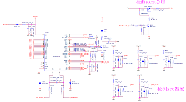

The customer design with BQ76952. LD connect 10Kohm to pack +. It is found that the AFE chip does not output DCHG and DDSG 5V signals.
After removing the resistor, it can output 5V normally.
Why does this happen? Is it possible to  not connect the 10k resistor?
 Please give some suggestions.

    The current schematic set-up should be okay but what I am unclear of is if the DDSG and DCHG pins are configured correctly. Could you please send device register settings or preferably the .gg file to verify ?
    As for the LD pin there are some considerations to be taken for low-side FET drive. The following application note: https://www.ti.com/lit/ml/sluaa84a/sluaa84a.pdf Section 7 Controlling LD may provide some insight. It is mentioned that the LD pin can have a series resistance between it and Pack+ or it can also go to directly to VSS with some caveats further described in the app note. I am unsure if the LD pin can be left floating but I can follow up on this next.

    Thanks for your reply.

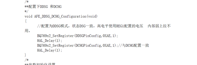

    The customer does not use the BQSTUDIO, they only can provide the registers setting code as below:
    The configuration of DDSG and DCHG is shown in the following figure
    the full registers setting as below:

    **配置下DDSG 和DCHG
    void AFE_DDSG_DCHG_Configuration(void)
    	//配置为DDSG模式,状态DSG一致,高电平使用REG1配置的电压  内部弱上拉不用,
    	BQ769x2_SetRegister(DDSGPinConfig,0XAE,1);
    	HAL_Delay(1);
    	BQ769x2_SetRegister(DCHGPinConfig,0XAE,1);//与DCHG配置一致
    	HAL_Delay(1);

  • Hi Star,
    The settings you sent look good to me, I cant really explain why you are seeing this behavior when you have the 10kOhm resistor vs without it on the LD pin. I have verified that if the LD pin is left floating in the case of low-side FET drive (DSG and CHG FET drivers not used) this should be okay but in general we think that tying it to VSS would be safer.
    On another note, on the schematic we do recommend you use capacitors to ground instead of zener diodes or Schottky diode if you prefer this on the SRP/SRN pins. This is because the zener may affect your voltage measurement. You may also see this E2E discussion where it is discussed further in the thread:https://e2e.ti.com/support/power-management-group/power-management/f/power-management-forum/1080696/bq76952-bq7695202
    -Luis Torres
