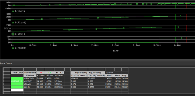

Hi Team,
I am simulating the pSpice model of LM5146-q1 available on ti.com.
I have set the current limit using design calculation sheet available on the product page to 15A i.e R(ilim)= 681 ohm. (Rds(on sensing))
My output voltage is set at 14.5V and R(Load) = 0.6 ohm.

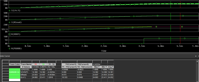

When simulating the current is not being limited to 15A. It is going upto 29A.
Please suggest here.
