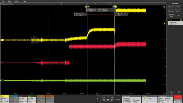

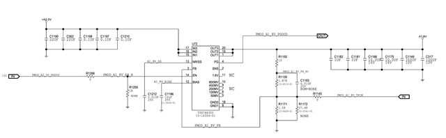

I used TPS7a8300 in my design to generate A1.8V from A2.5V. There is another power rail P3V3_Z0 which was enabled ~550ms later than A1.8V.
Observed once P3V3_Z0 is enabled (ramped up), A1.8V is bumped up from 1.8V to 2.1V.
I manually added a 100ohm bleeding resistor on A1.8V, then no bump up any more.
Why TPS78a8300 can be charged up to 2.1V and stays stable at 2.1V? Measured FB voltage, it got bumped too. Looks the control loop can't turn FB voltage back to Vref.
Why a 100ohm bleeding helps here? Given 100ohm will have only 18mA loading current on A1.8V.
Yellow-- P3V3_Z0
Red-- A1.8V
