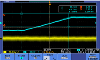

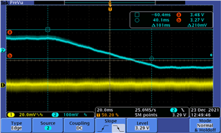

    i think i know you concern that there will be larger noise in buck boost mode, right?  if so, that should be ok as the picture below. almost same output noise in boost and buck boost mode.
    it was a line sweep tests, the output voltage is 3.3V and device will go through buck, buck-boost and boost mode during this sweep.
